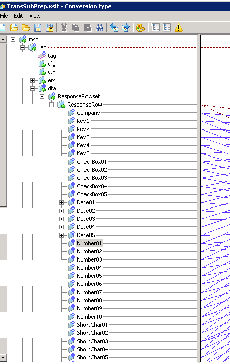

if your intent is to process each row that comes back from your query, you’ll want to do that query in the parent. Make sure you save the output of that query as a schema which should format as multiple rows for you.
this is an example of what your schema could look like from your DB output
Assign that schema to the input schema of your sub workflow element (or remap to a different schema in a conversion beforehand), and then create a sub workflow schema from that based on the row node.
