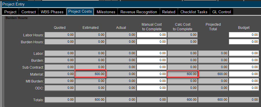

Other - The cost of the PO showed up under Estimated Material Cost in Project Entry and does not move to Actual after we pay the PO.

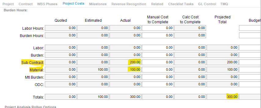

So the $500 is my buy to other PO and $100 is job material. I actually can’t really see where that $100 went on here but it’s included in the Projected Total.

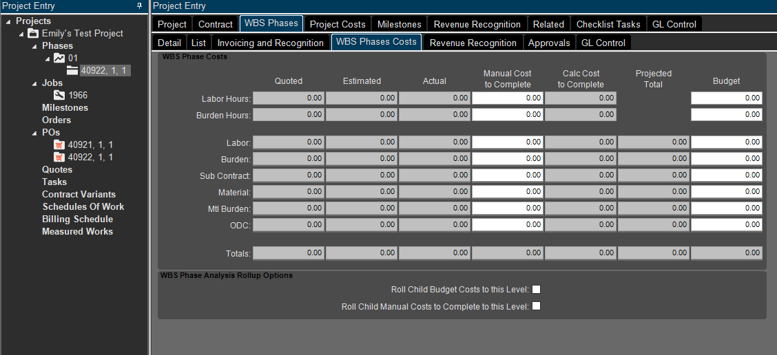

Does $100 show on the Phase Job (in the WBS Phases tab) for the Project Job of the Phase used on the Purchase Order?
I didn’t create a phase for my test project but I tried it just now (also processed Build Project Analysis) and the $100 is still nowhere to be found :woman_shrugging:

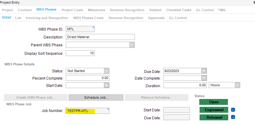

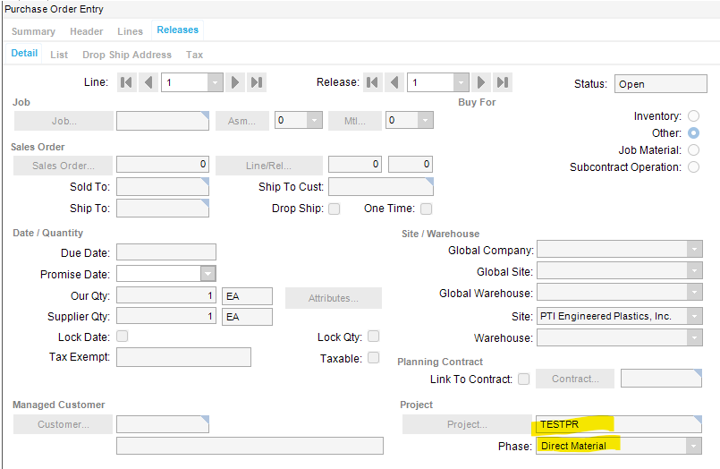

I set up a Test Project with one Phase and made sure the Project and Phase Jobs existed:
Entered an OTHER PO type with a Part on the Fly for $100 USD. On the Release Tab, I entered the Project and Phase.

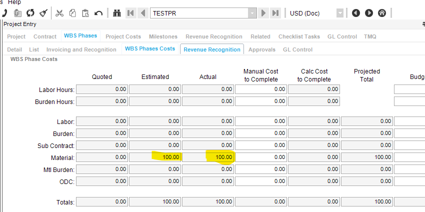

Then I received the PO. I checked the Phase Costs:

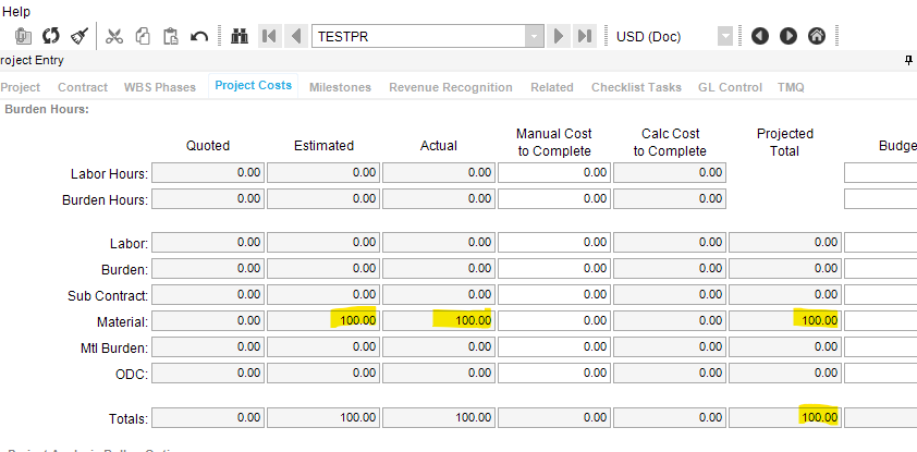

Did a Build Project Analysis and the cost shows in the Project too.
Oh I see. So we need to receive the Other PO. Thank you so much! This will work perfectly!

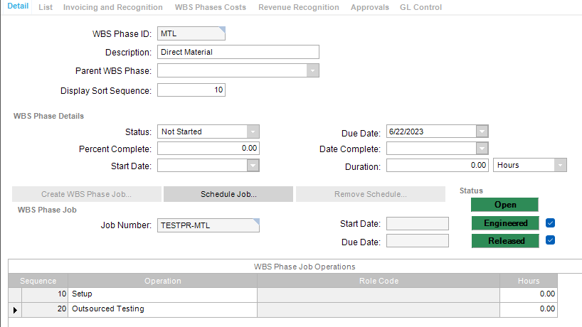

If you want to use Subcontracting lines, you can use the “Add A WBS Phase Operation” and choose a Sub-Contract Operation. A lot simpler than opening a new job and linking it.
Enter a Subcontract line on the PO. The Operation didn’t show but I could type it in. Since it’s a project phase job, I didn’t have to update the Release tab. Kinetic does it automagically.
Received the item and ran the Build Project Analysis.
Thank you so much, Mark! This might work better since the cost is showing up in a different bucket in Sub Contract so that it doesn’t get mixed in with Materials.
