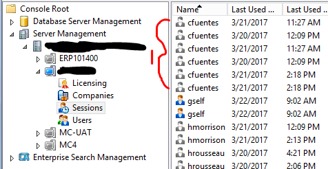

Does an accumulation of old sessions (displayed in the Admin Console) indicate anything that needs to be looked into?
For example, the screen shot below shows user cfuentes with 6 inactive sessions.
Is this something that might indicate a problem waiting to rear its ugly head?
Also - We run the client via a Web App Not the Epicor Web Access Extension. Our’s is like Citrix, but not Citrix,
Zombie sessions are usually when someone does not logout. It could be because they have not touched their box in forever and someone else stole their license ticket. Otherwise it could be due to signed in on laptop and unplug from network / crash on close, etc.
They don’t count against licenses, they take up a couple hundred bytes each in the db so really are not an issue. They will be cleaned up in 72 hours. (So people can leave their boxes on over the weekend and keep their session).

As I said, our users run it as an RD App. So it is most likely that their RD session times out, leaving the E10 client session (on the RD App server) orphaned.

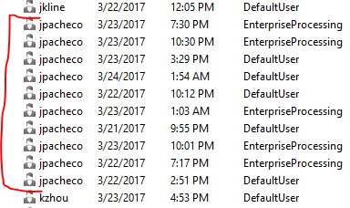

One other related question. All users - but one - have a session type of “DefaultUser”. The one exception is a user whose sessions vary between “DefaultUser” and “EnterpriseProcessing” (see pict below)
This user isn’t anything special, and doesn’t run any processes like MRP , Capture COS/WIP, PO Suggestions, etc…
And what is an “Enterprise Processing” session?

It just means the user has multiple concurrent sessions enabled.
Let me give you my post first cup of coffee answer. If a user is logged in and launches and program and then changes companies they will switch their licensing type to this.
Hmmm … That raises more questions, as we have only one company setup. Would switching sites/plants within a company possibly do that?
Yes, switching plants would also change the licensing type
The EAC help has information regarding the different session types in the Session List Fields topic.
Additionally (and, perhaps most importantly) Enterprise Processing session types don’t consume a license from your license pool. For userA if there is one defaultuser session and userA also has 20 enterprise processing sessions, there is only one concurrent office user license being consumed.
