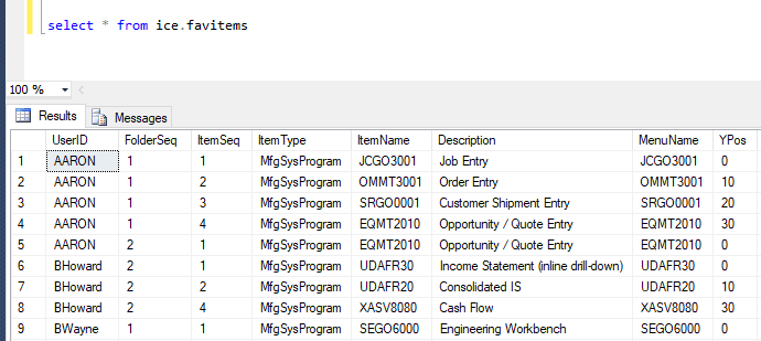

Sort order I believe is determined by Ice.FavItems.ItemSeq for items within the same FolderSeq. It’s a first in, first displayed feature. I would never recommend that one update the ice.favitems.itemseq based on description ascending for items within the same folder (folderseq). NEVER!

While that worked for Modern interface, I don’t believe it works for Kinetic interface. It seems like the Kinetic ones are sorted under the YPos field.
