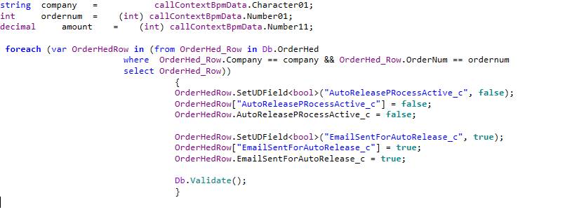

Hi @klincecum
string  company   =           callContextBpmData.Character01;
int     ordernum  =    (int) callContextBpmData.Number01;
decimal     amount    =    (int) callContextBpmData.Number11;
 foreach (var OrderHedRow in (from OrderHed_Row in Db.OrderHed
                        where  OrderHed_Row.Company == company && OrderHed_Row.OrderNum == ordernum
                        select OrderHed_Row))
                                  OrderHedRow.SetUDField<bool>("AutoReleasePRocessActive_c", false);
                                  OrderHedRow["AutoReleasePRocessActive_c"] = false;
                                  OrderHedRow.AutoReleasePRocessActive_c = false;
                                  OrderHedRow.SetUDField<bool>("EmailSentForAutoRelease_c", true);
                                  OrderHedRow["EmailSentForAutoRelease_c"] = true;
                                  OrderHedRow.EmailSentForAutoRelease_c = true;
                                  Db.Validate();

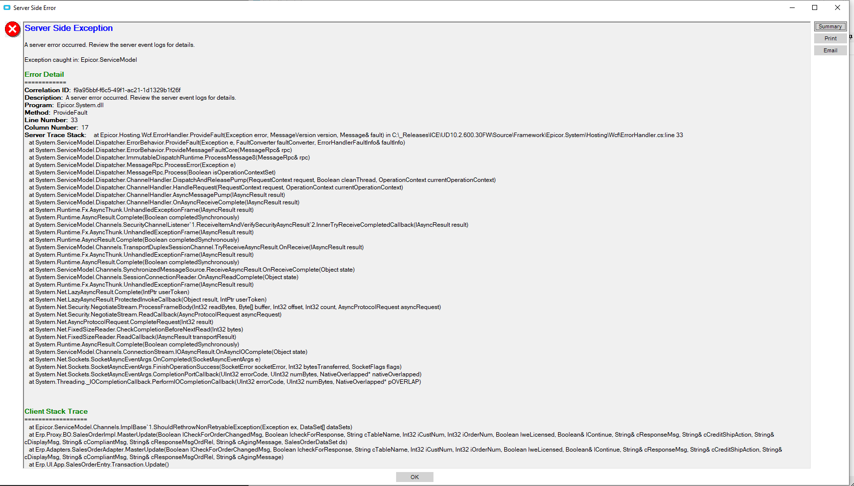

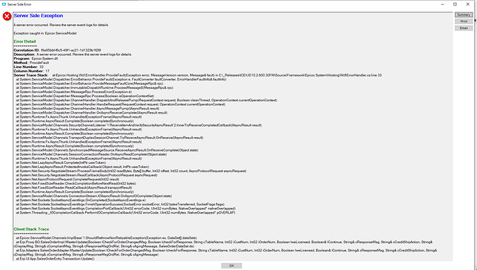

And what is the full stack error?

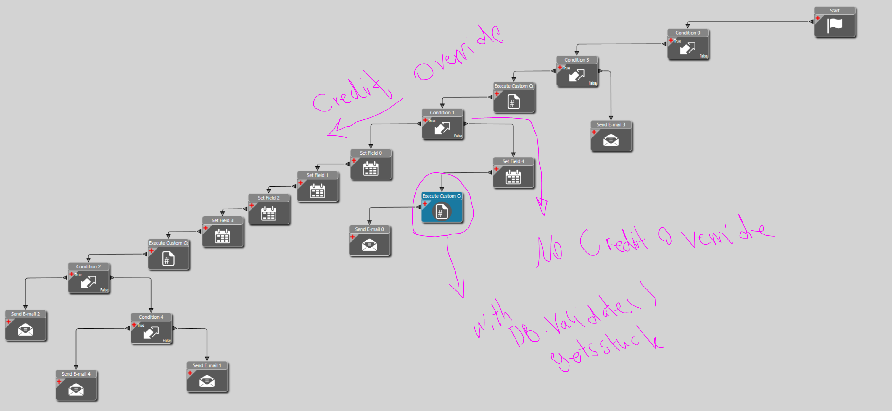

This is a screenshot of the Post-Processing.
The BPM malfunctions and gets stick at the CustomCode (encircled in purple) and does not move to Email section:
I just realized that it is throwing an error in the MasterUpdate

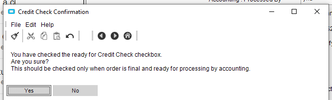

All that it does is showing a BPM form

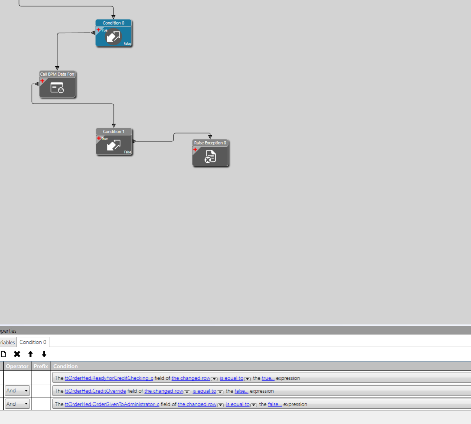

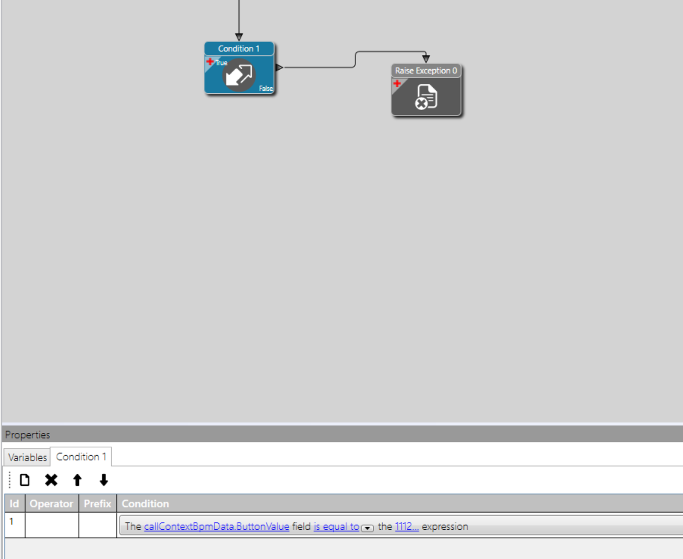

First condition in the Master BPM:
Second Condition in the Master BPM:

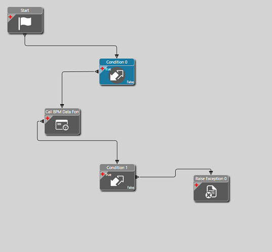

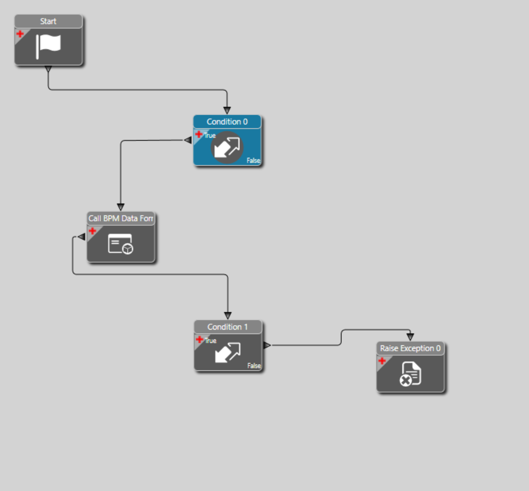

The BPM form:
Yes I was just looking at that. You’ll probably need to set that field at master update.
Probably no need to do it at the Db context there either.
