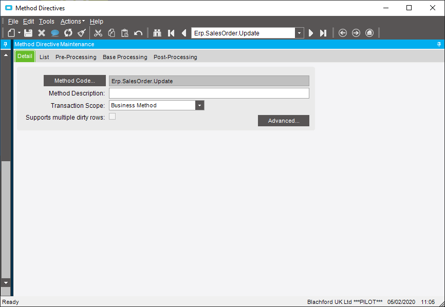

We have a couple of BPM’s on Sales Order Entry and we use this directive:
