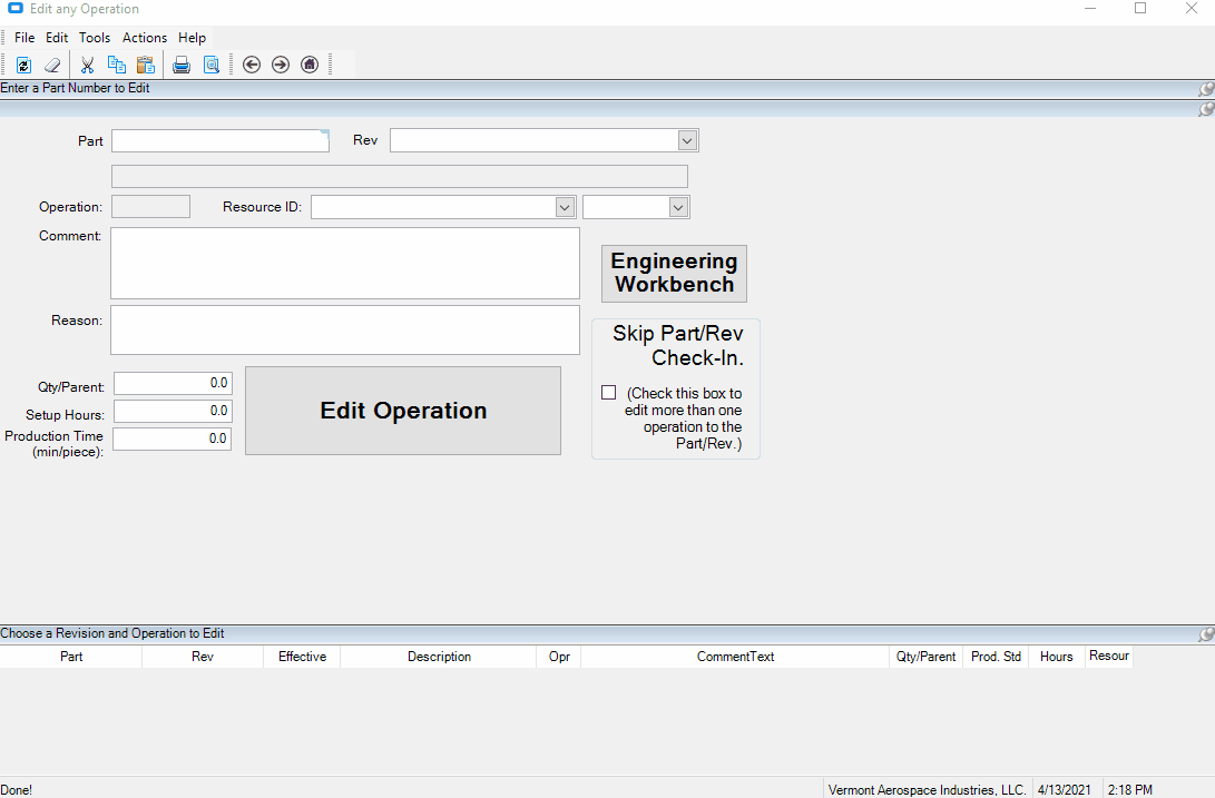

Good afternoon,
I am trying to set a custom EpiUltraGrid to read only. I have already populated the grid with data from a BAQ. I set the grid to read only through code. But when I look at the grid, only the rows that are visible on the screen are set to read only. If I scroll down the grid one or more rows, then all rows below the ones initially displayed are not set to read only. If I rerun this function after scrolling down, then only the rows currently visible in the grid are set to read only, any rows above or below are editable. What the heck is going on here?
Here is the function where I set the grid data source and try to set it to read only.
private void CheckForCheckedOut()
	//If this part/rev is checked out to the current user's eco group, then display warning. AND Show the ECO Grid!
		EpiDataView edv = (EpiDataView)this.oTrans.EpiDataViews["CallContextClientData"];
		string myUserString = edv.dataView[0]["CurrentUserId"].ToString();
		DynamicQueryAdapter dqa = new DynamicQueryAdapter(oTrans);
		dqa.BOConnect();
		QueryExecutionDataSet qeds = dqa.GetQueryExecutionParametersByID("getPartRevOpECO");
		qeds.ExecutionParameter.Clear();
		qeds.ExecutionParameter.AddExecutionParameterRow("part", txtMyPart.Text, "nvarchar", false, Guid.NewGuid(), "A");
		qeds.ExecutionParameter.AddExecutionParameterRow("rev", revCombo.Text, "nvarchar", false, Guid.NewGuid(), "A");
		qeds.ExecutionParameter.AddExecutionParameterRow("ECOGroup", myUserString, "nvarchar", false, Guid.NewGuid(), "A");
		dqa.ExecuteByID("getPartRevOpECO", qeds);
		if (dqa.QueryResults.Tables["Results"].Rows.Count > 0)
		// This part is checked out! Flag the screen and show the warning.
			lblCheckedOutWarning.Visible = true;
			ecoUltraGrid.Visible=true;
			ecoUltraGrid.DataSource = dqa.QueryResults.Tables["Results"];
			oTrans.NotifyAll();
			ecoUltraGrid.ReadOnly = true; // Set grid to read only! Rows below initial screen are not readonly!
			ecoUltraGrid.Refresh();
		else
			lblCheckedOutWarning.Visible = false;
			ecoUltraGrid.Visible=false;
			oTrans.NotifyAll();
In the attached GIF you can see me demonstrate the issue. The table in the middle is the custom epi ultra grid that I want to be completely read only. Instead you can see only the visible rows are set to read only.
