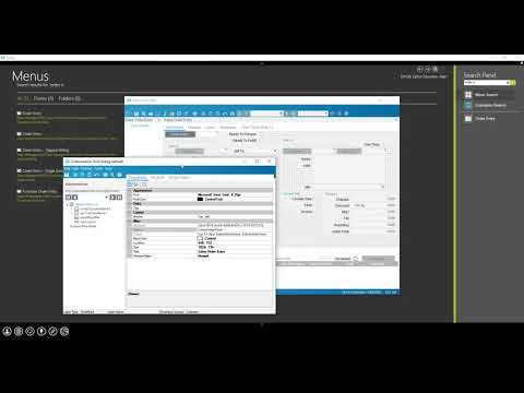

BAQ Dataview Example Video
Here’s an example video of how to do a BAQ dataview.
BAQ Dataviews are a great way to view related data onto a screen in Epicor. If you can link the data on the screen to the data you want to display in a BAQ you can display it. They are faster and more flexible than FKVs or embedded dashboards.
and the code.

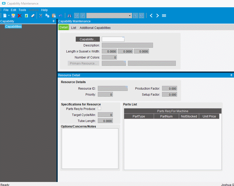

I hope Josh doesn’t mind me sharing his screenshot, but what Josh is refering to is he actually uses UBAQ BPMs to manage the grid, no client side code (or atleast minimal). It becomes it’s own isolated business logic grid.
UBAQView
You know the UDXX Wizard Generated Code… its much cleaner as a BAQDataView, and can easily be re-used in other screens.
Good god where did you dig that up HA HA HA!

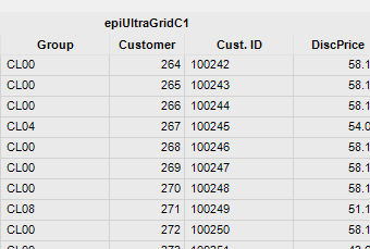

I must not be doing something correctly. If I have just one binding it works just fine. It’s when I try to add the second one in, it just seems to ignore one or the other. In this case, it’s returning the part with all of the customers listed. It doesn’t matter if I put CustID first or second.
	public void CreatetrkCustomerPricingBAQDV()
		trkCustomerPricingBAQDV = new BAQDataView("trkCustomerPricing");
		oTrans.Add("trkCustomerPricingBAQDV",trkCustomerPricingBAQDV);
		string pub1Binding = "MyCustomerData.CustID";
		IPublisher pub1 = oTrans.GetPublisher(pub1Binding);
		if(pub1==null)
			string pubName = Guid.NewGuid().ToString();
			oTrans.PublishColumnChange(pub1Binding, pubName);
		if(pub1 !=null)
			trkCustomerPricingBAQDV.SubscribeToPublisher(pub1.PublishName, "Customer_CustID");
		string pub2Binding = "Part.PartNum";
		IPublisher pub2 = oTrans.GetPublisher(pub2Binding);
		if(pub2==null)
			oTrans.PublishColumnChange(pub2Binding, pubName);
		if(pub2 !=null)
			trkCustomerPricingBAQDV.SubscribeToPublisher(pub2.PublishName, "Part_PartNum");
Yields this:
I don’t know if I’m just misunderstanding, or if something isn’t working.
Thanks!
What screen are you adding it to? Does the screen have EpiDataViews of MyCustomerData and Part?
I’m adding it to the part tracker. I have a custom EpiDataView that I store the customer data in, I have bound textboxes as well to make sure they are properly populated. The data refreshes when I put a new part in, but it doesn’t care about changing the CustID (or CustNum) field. I have a feeling I’m misunderstanding something which would explain it.
You could remove the customer ID publish/subscribe relations and do a post filter.
trkCustomerPricingBAQDV.dataView.RowFilter = String.Format("Customer_CustID= '{0}'", insert_customer_ID_here);
I did try that. The query is pretty intense, so I have changed it to a parameterized query where I just get one row back. It takes 1/10th the time. I was just hoping I could figure out something about this because this way is much easier.
