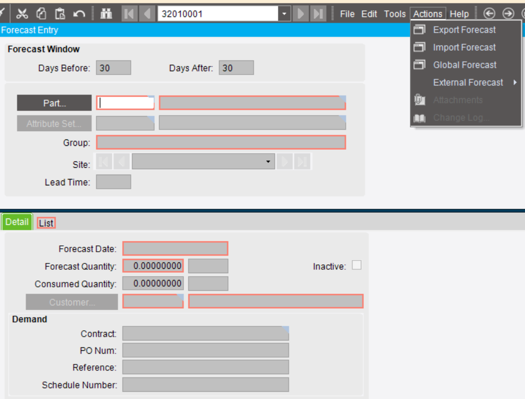

You can add the parts to Forecast Entry, which should then create a purchasing suggestion.
I would like to have POs suggested or created periodically.
If I put it in the Forecast Entry, isn’t a one-time PO corresponding to that Forecast created? Also, if the part is in stock then PO will not be suggested.
You’d have to set up a monthly requirement in Forecast. Every month would have demand. Then you’d tweak the part-level Days of Supply and Min/Max Lot Size settings to force MRP to spit out separate PO’s of appropriate qty.
You can also set a safety stock or min on-hand settings so that, even if some pieces are still on hand, it will still prompt a re-order.
I don’t see a column in the Forecast Entry that sets the monthly requirement you said.
Are you saying that I have to enter a different Forecast every month?
The purpose of this case is work efficiency. Entering a Forecast on a monthly basis is the same as creating a PO on a monthly basis. And we have to buy the quantity with or without on-hand.

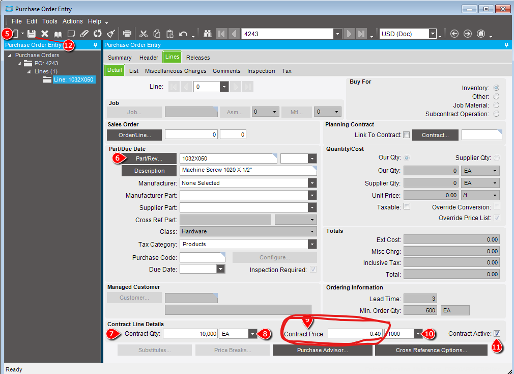

Epicor has a module called Purchase Contracts which does this.
This feature seems to be close to what I was looking for. But we change the unit price/quantity a little every month. This feature seems to create a PO with a fixed unit price/quantity. Is there any setting that can compensate for this?
Usually the price can be set on the supplier price list. I’m not sure with the module though.
I just tested this feature on the Pilot, and the Price/Qty seems to be locked to the Contract Price/Qty.
