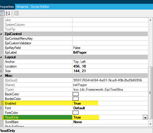

Why doesn’t read only work in customization? I can still edit the field and save it. If I choose disabled then the field is grayed out and can’t even be selected.
read-only-does-nothing
End goal is for the field to be able to be selected and text highlighted so it can be copied, but not changed and saved. Disabled does not allow that. And read-only still allows save. Is that known issue?
And, yes I have cleared cache and relaunched the form after setting read-only.

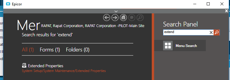

For an epibound field you have to change it in your extended properties (this will change it everywhere) or you have to do it in code on form load. It’s annoying, but that’s the way it’s intended.
I’m okay with it being read-only everywhere for this case.
Where can I find extended properties for a text field though?
It’s for the field that you have bound to the text box.
Okay thanks I didn’t understand that Extended Property was its own separate screen.
Yeah, I’m just figuring this stuff out too.
You can do it at form level too. Tools, Wizards, Customisation Wizard. There is one called Modify Extended Properties or something similar.
