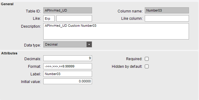

Maybe Number03 is somehow missing. Can you see it in Extended UD table maintenance and in the dbo.APInvHed view in SSMS?
I assigned the sum in my routine to rounding and it shows in the data.
That’s a good point actually.
Did you ever have data in that field in E9? If not, the upgrade won’t bring that field over and it won’t exist.
It does exist:
Going to try some other ways to call that table since there’s a “_UD” at the end of it.

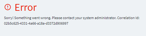

The database context will include the _UD table in the ds.APInvHed object. Have you run a debugger on the code to see what the ds.APInvHed object looks like?
I’m sure there’s a better way to debug, but I set
callContextBpmData.Character05 = ds.APInvHed.ToString();
and threw it on a show message widget and got this:
What exactly did these messages say?
Have determined that this usually stems from something wrong with my BPM.
Check the event viewer on the server for the specific message. Should help you narrow it down more.
I think it’s tt.SetUDField<decimal>("Number03", amtSum); that is causing it because when I comment that out, it runs fine. It just seems like every time I try and fill that UD field, things go wrong.
