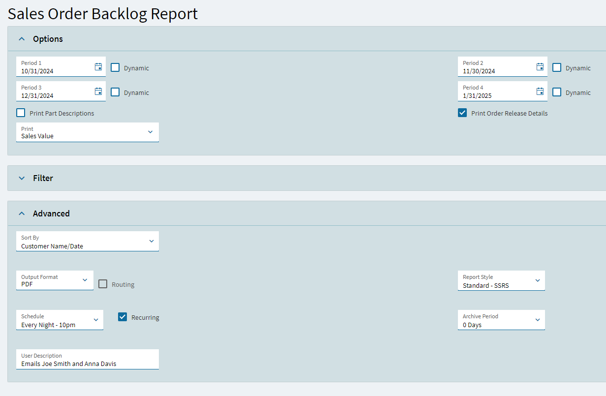

I have a user that would like to run a report regularly. I know Epicor is quite capable of this, as we already have a check run every week. Except I did not create it, it was before my time…
Does anyone have any documentation or guides on how to go about working with scheduling, process sets, etc.?

I’m not sure of the documenation officially, but you create a schedule in System Agent. Then on any report, there is a drop down that usually defaults to Now for Schedule. You click that drop down and select which schedule you want to run it on. Then the Recurring checkbox becomes available and you’d check that box to run it every time on that schedule (as opposed to just once). That’s it. You can choose to email it and select what type of file it generates (which I personally use the heck out of).
To delete them after the fact, you can either go to System Monitor and the Scheduled Tasks tab (which will show you yours only) or you can edit in System Agent under the Schedule that you set in Tasks panel.

It’s relatively simple. Your report will need to be setup so that it can be emailed (APR) to the Distribution List and the appropriate Schedule created or identified. Someone will need to initiate the Report, select the desired Schedule, mark as Recurring, and either Preview or Print. The Report will run at the designated time and email to the Distribution List.

It can be done.
Fastest is similar to what Bruce said.
Build Report
You can setup a special user account for reports/processes or w/e it will run under.
Create Schedule
Print to email of report and assign to schedule (recurring) with appropriate parameters using the above service account.
(I have a couple that are sent to appropriate DLs. One is WIP Recon as was requested by accounting dept for WIP Recon weekly so the SGM shows reasonable margins and not 100%'s when sales runs the SGM report unless there is some other issue.)
AFAIK, if it is tied to recurring schedule it will run @ server and does not require user intervention to retrieve. (At least in 10.2.600.26)
