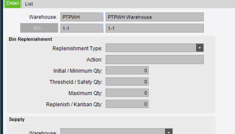

Ive used this before at a previous company, but for some reason this is greyed out and i cannot add a Bin to the part to add a Move Kanban setting. i have a kanban set up to purchase at the warehouse level. What am i missing?
you can only have a Kanban warehouse or a kanban bin set up. If you have the other one set up, it will not let you create the opposite. Maybe that’s your problem?

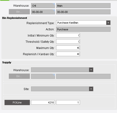

I am trying to setup a Purchase Kanban at the bin level no PO releases are being created. I have multiple bins for the same item and I have setup each bin as follows:

This depends on what version you are on… but the system only triggers a new release to be created on the PO when you fall BELOW the trigger qty… I cannot tell your trigger qty by the screen shot, but it looks like zero to me… try increasing the trigger point
