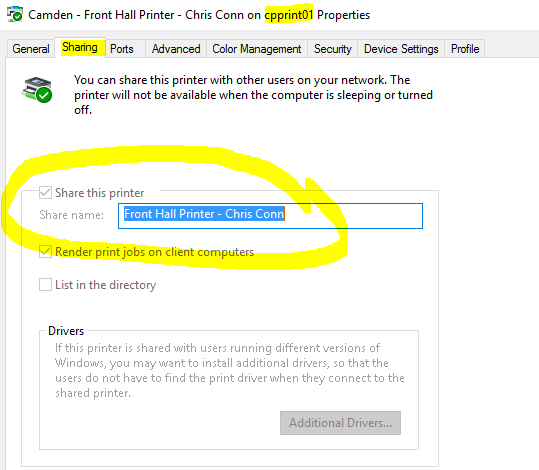

Share your printer from the PC it is attached to. The path is \PcName\PrinterShareName.

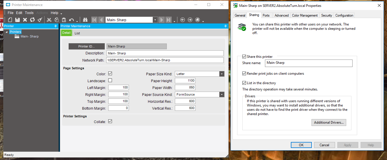

Thank you for this, but I think I am still doing something wrong… I have attached the info for the printer I am trying to add.
A few things. First I suggest a printer name with no spaces.

OK so we can see the server. Try making a short simple printer share name.
Then update the path in epicor and try again. Also, how are you trying to

Okay, something is still not working… Am I typing the Network Path in correctly?

Yep looks proper (so long as that FQDN pc name is valid). When you did ping, did you use that full name? server2.absoluteturn.local?
