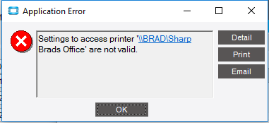

I just tried to print using the Client Printer, and this is the error I got? This is another printer we have on our server, but not the main one I am trying to get Epicor linked to. Well I would eventually want to get Epicor linked to all, but right now I am just trying our main printer.

Application Error
Exception caught in: System.Drawing
Error Detail
Message: Settings to access printer â\BRAD\Sharp Brads Officeâ are not valid.
Program: System.Drawing.dll
Method: GetHdevmodeInternal
Client Stack Trace
at System.Drawing.Printing.PrinterSettings.GetHdevmodeInternal(String printer)
at System.Drawing.Printing.PrinterSettings.GetHdevmodeInternal()
at System.Drawing.Printing.PrinterSettings.GetHdevmode()
at System.Drawing.Printing.PageSettings.GetPaperSize(IntPtr modeHandle)
at System.Drawing.Printing.PageSettings.get_PaperSize()
at Ice.Lib.Report.PrinterPageSettings.FromPageSettings(PageSettings pageSettings)
at Ice.Lib.Report.ClientPrinterManager.FillPrinterInformation(String printerName, PrinterSettings printerSettings, PrintersDataTable printersTable)
at Ice.Lib.Report.ClientPrinterManager.<>c__DisplayClass8_0.b__0()
at Ice.Lib.Report.SSRSDialogPropertiesManager.TimeAction(Action action, String label, Boolean indent)
at Ice.Lib.Report.ClientPrinterManager.FillAllPrintersInformation()
at System.Lazy1.CreateValue() --- End of stack trace from previous location where exception was thrown --- at System.Runtime.ExceptionServices.ExceptionDispatchInfo.Throw() at System.Lazy1.get_Value()
at Ice.Lib.Report.ClientPrinterManager.FillClientPrinters(PrintersDataTable printersTable, PrinterPaperSourcesDataTable paperSourcesTable, PrinterPaperSizeDataTable paperSizesTable)
at Ice.Lib.Report.SSRSDialogPropertiesManager.b__38_0()
at Ice.Lib.Report.SSRSDialogPropertiesManager.resetMode(String companyId, Int32 styleNum, String reportID)
at Ice.Lib.Framework.EpiReportTransaction.setPrinterOptionsSSRS(String reportID, Int32 styleNum, PrinterDialogMode mode, Boolean initializeSettings)
Is \BRAD\Sharp Brads Office installed as a printer under the Windows user profile of the appserverâs application pool identity? Additionally, does the application pool identity have access to that printer? (if it isnât a domain user, you may wish to change it).

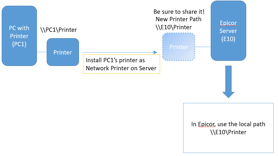

Nathan makes a good point. I know that in my case, the printer is actually installed on the Epicor server, even though it is physically attached to a different PC. Maybe try that if you havenât already.
Install the desired printer as a network printer on the server, then try to share from server and use that address:
\EpiServer\PrinterShare
Admittedly it seems a little convoluted, but if nothing else has worked, itâs worth 15 minutes to try

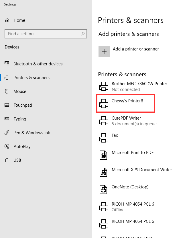

@ Jaime_Hernandez,
If you review your Windows printer names, do you have any with an apostrophe or have a printer that is offline? If so, can you rename the printer as to not have an apostrophe (and if any are offline, can you uninstall that printer or turn it on), log out of the client and back in, and try to print again?

In our older ERP10 versions, we werenât properly escaping apostrophes in the printer name list and donât recall the specific release, but, sometime in the early ERP 10.xâs we fixed the glitch.

Right, printer names should not have special characters, especially single quotes.
The reason for this is it can mislead programming - in SQL the single quote is used for text constant values. So if you have something like :
concatenate (âserverâ, ââ, printer name) this would translate to
server\Chewi and then have âs Printer!â which would have absolutely no meaning to the program.
SO avoid using single quotes , ! and even spaces in printer names in any occasion. Instead you can use big caps and small caps, eventually also _ to make it reasily readable like Chewi_s_Printer.
Same rule goes also for other places where you need to use custom ID (ex: BAQ ID).
