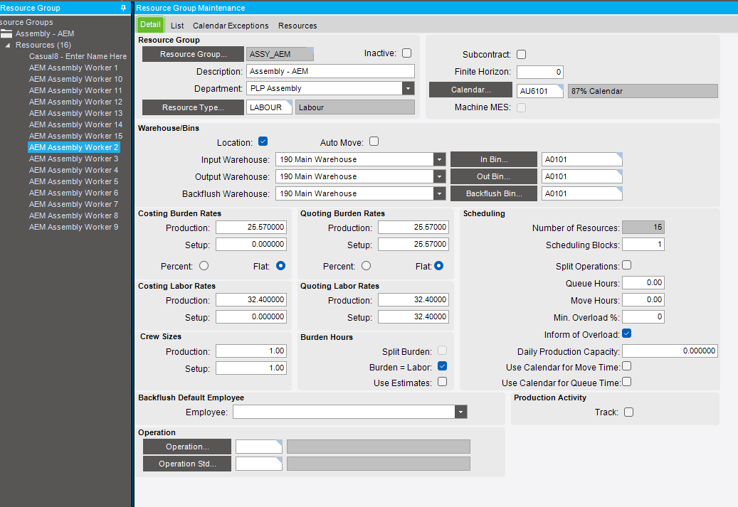

Our finance team has made the decision to not include setup hours in labour hours for jobs since they have already accounted for the setup in burden rate (dont ask me how). We have marked setup costs as 0 in all resource groups for setup as per the screenshot attached (Costing burden rates for setup = 0 AND costing labour rates for setup = 0)
We do NOT want to include setup hours into costs (decision made by finance department) therefore in our jobs we do not want any hours recorded by an operator as setup to be included in the costing.
However, we observe that while this works properly in estimated labour hours (Which is Estimated production labour hours * Estimated resource rate) when the actual labour hours are recorded by an operator on a job the cost are calculated as per the formula - ((Setup hours + production hours) * labour rate).
We want this to be ONLY production hours * labour rate.

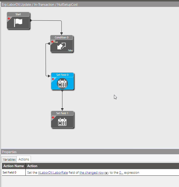

To anyone who’s interested in how I solved this problem - simple BPM :slight_smile:
Data directive in-transaction on laborDTL table
