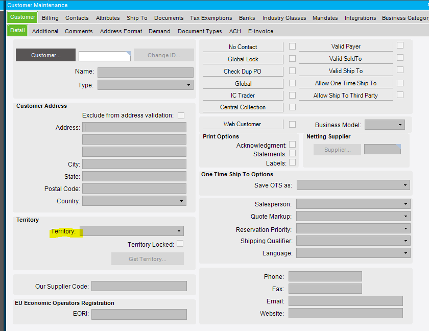

It might caused by territory restrictions from the customer table.
It appears there is only one territory available for all customers “United States”. Our company is not using the sales force options in e10.
