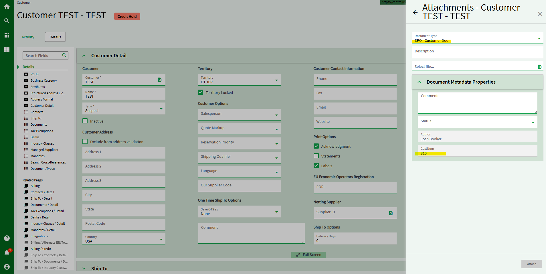

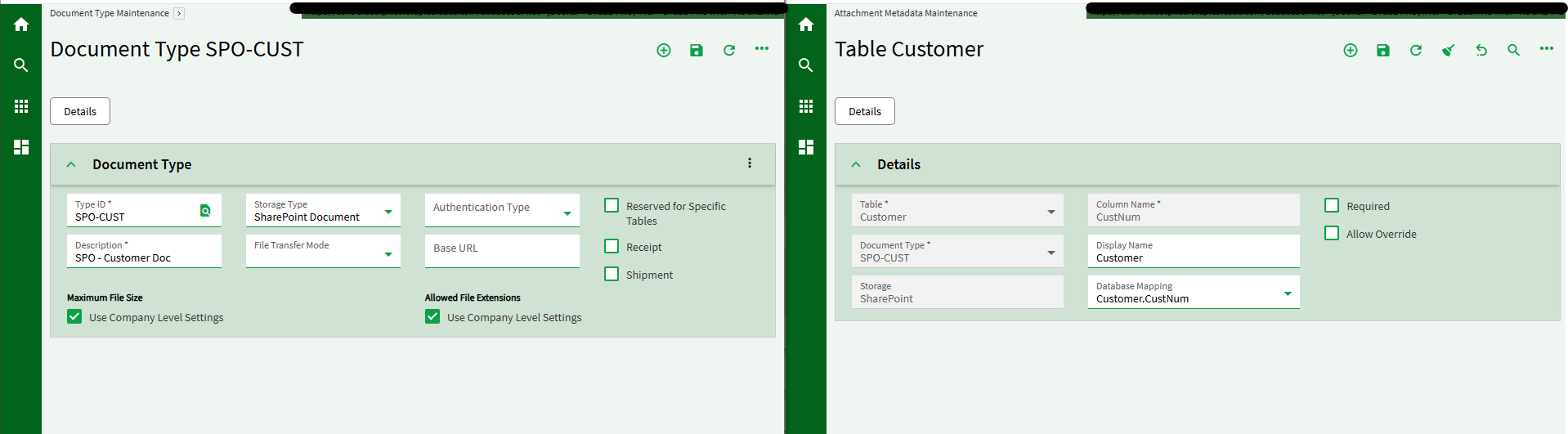

You can setup a Document Types and related Attachment Metadata and can map fields from ERP tables to Sharepoint columns. So it’s up to this mapping whether you want generic column names in SPO vs CustNum, PartNum, etc.
You could build up a link and pass the filter using a metadata column or the SysRowID (built-in without metadata mapping) like so:
{BaseUrL}/Customer?FilterField1=_TableSysRowID&FilterValue1=de6e4561-e0c2-4116-8cb4-26722984e97a&FilterType1=Text
