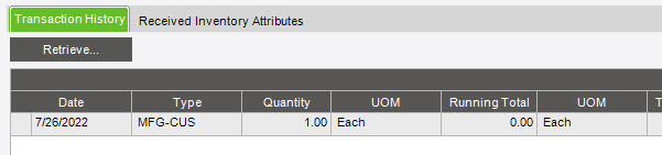

I was just looking at some of my closed order releases that still have open jobs.
Here is one of mine, for an incomplete job:
My understanding is you can tell epicor you shipped anything…
Epicor will not prevent you from entering and shipping a shipment against a job that is still open, but if there are any additional costs added to the job then they will not necessarily be included in the shipment’s COGS.
We will sometimes ship against open jobs if we’ve expedited part of the order, but we have to watch order transactions are entered to make sure costs are flowing correctly.
If you are talking make direct the only constraint is you cannot ship a closed make direct job. That being said you want to ensure jobs don’t close until after invoicing if you want to capture P/L properly.
The production quantity doesn’t need to be complete to ship a job. You also can ship a job that is marked complete.
