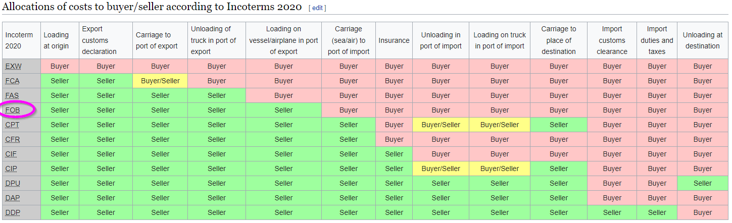

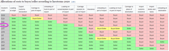

@Mark_Wonsil you beat me to it. Incoterms is the answer. In fact, for some customers, we have entered the Incoterms table into the FOB Setup. Note that FOB is ONE of the Incoterms for international commerce. See Incoterms - Wikipedia for the complete list of Incoterms.
