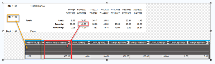

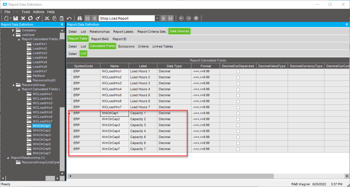

Like many reports, the RDD for Shop Load has calculated fields. Does anyone have ideas how Epicor calculates the Capacity buckets? Out plant manager is basically asking for a dashboard version of this report and I’m struggling to figure out how these are calculated.
Is it not the sum of the capacity for the Resource Group based on the time period selected on the print dialog?
The numbers aren’t lying up unless I’m doing something wrong.

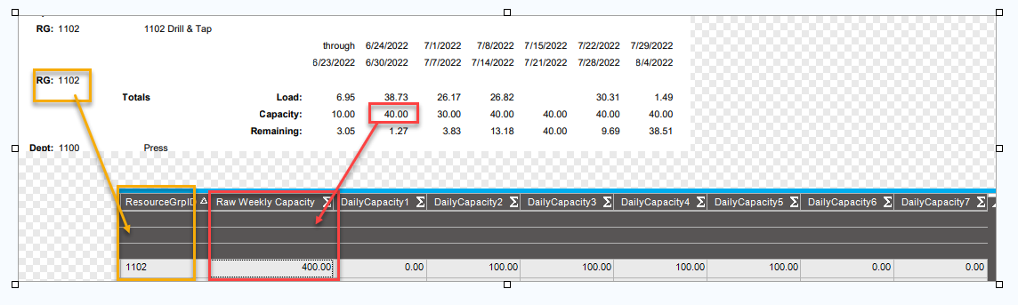

Yes we do have multiple but each Resource Group ID is assigned to one. I guess my struggle is how to parse the ProdCal table and also to check for holidays. I’ve never touched the ProdCal table before.
Edit: I believe you’re right, it’s the Resource Group “DailyCapacity” fields, just need to check for holidays that fall within the week. Thanks!

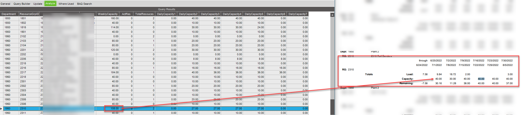

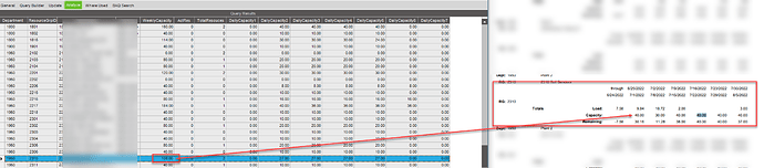

When you run the Capacity Generation, do you delete the old capacity? Maybe you need to filter the results by CapRevID?
I wonder if that’s what’s causing this, some resource groups are perfect others are way off
What are your hours per day (8, 10, etc.)? How many resources in that resource group?
Isn’t the Daily Capacity fields “Hours”? I was just summing them all together for a “Weekly” total.
Yes, but I don’t know the specifics of your setup and was trying to see why the hours were so far off. I figured if I knew how many hours your calendar has and the number of resources in the group might help me figure it out.

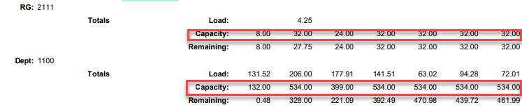

Correct again, we have disabled Resources in some groups so I need to account for that.
Closer, most are working but I’ve found a few problem children. This one doesn’t have any active Resources so doesn’t get onto JobOps at least so that may be part of the issue. This also doesn’t account for Holidays yet as I’m still verifying the “base” Weekly Capacity calculations.
Ok, the issue above was because the Resource Group didn’t have an assigned calendar and thus used the Site’s default Calendar. Plus I wasn’t checking for the number of Active & Total resources which are needed to get the proper hours using the RG’s fields.

This one also works as long as all RG’s have an assigned Calendar, I switched to the above instead of modifying this one more.
select distinct
	[ResourceGroup].[JCDept] as [ResourceGroup_JCDept],
	[ResourceGroup].[ResourceGrpID] as [ResourceGroup_ResourceGrpID],
	[ResourceGroup].[Description] as [ResourceGroup_Description],
	(CASE WHEN (ResourceGroup.CalendarID) is null then 9999
 ELSE
   (CASE WHEN TotalResouces = 0 THEN
     (CASE WHEN ActRes = 0
     THEN (ResourceGroup.DailyCapacity1 + ResourceGroup.DailyCapacity2 + ResourceGroup.DailyCapacity3 + ResourceGroup.DailyCapacity4 + ResourceGroup.DailyCapacity5 + ResourceGroup.DailyCapacity6 + ResourceGroup.DailyCapacity7)
       ELSE ((ResourceGroup.DailyCapacity1 + ResourceGroup.DailyCapacity2 + ResourceGroup.DailyCapacity3 + ResourceGroup.DailyCapacity4 + ResourceGroup.DailyCapacity5 + ResourceGroup.DailyCapacity6 + ResourceGroup.DailyCapacity7) / TotalResouces ) * ActRes
     END)
   ELSE
     (CASE WHEN ActRes = 0 THEN 0
     END)
   END)
  END) as [Calculated_WeeklyCapacity],
	[ResourceGroup].[CalendarID] as [ResourceGroup_CalendarID],
	(CASE WHEN (Resource1.Calculated_ActiveResources) is null
   THEN 0
   ELSE Resource1.Calculated_ActiveResources
 END) as [Calculated_ActRes],
	(CASE WHEN (TotResources.Calculated_TotalRes) is null
   THEN 0
   ELSE TotResources.Calculated_TotalRes
 END) as [Calculated_TotalResouces],
	[ResourceGroup].[DailyCapacity1] as [ResourceGroup_DailyCapacity1],
	[ResourceGroup].[DailyCapacity2] as [ResourceGroup_DailyCapacity2],
	[ResourceGroup].[DailyCapacity3] as [ResourceGroup_DailyCapacity3],
	[ResourceGroup].[DailyCapacity4] as [ResourceGroup_DailyCapacity4],
	[ResourceGroup].[DailyCapacity5] as [ResourceGroup_DailyCapacity5],
	[ResourceGroup].[DailyCapacity6] as [ResourceGroup_DailyCapacity6],
	[ResourceGroup].[DailyCapacity7] as [ResourceGroup_DailyCapacity7],
	[ResourceGroup].[Inactive] as [ResourceGroup_Inactive],
	[JCDept].[Description] as [JCDept_Description]
from Erp.ResourceGroup as ResourceGroup
left outer join  (select distinct
	[Resource].[Company] as [Resource_Company],
	[Resource].[ResourceGrpID] as [Resource_ResourceGrpID],
	[Resource].[ResourceID] as [Resource_ResourceID],
	[Resource].[Inactive] as [Resource_Inactive],
	(count(Resource.ResourceID) OVER (Partition By Resource.Company, Resource.ResourceGrpID)) as [Calculated_ActiveResources]
from Erp.Resource as Resource
where (Resource.Inactive = 0))  as Resource1 on
	ResourceGroup.Company = Resource1.Resource_Company
	and ResourceGroup.ResourceGrpID = Resource1.Resource_ResourceGrpID
	[Resource2].[Company] as [Resource2_Company],
	[Resource2].[ResourceGrpID] as [Resource2_ResourceGrpID],
	[Resource2].[ResourceID] as [Resource2_ResourceID],
	(count(Resource2.ResourceID) OVER (Partition By Resource2.Company, Resource2.ResourceGrpID)) as [Calculated_TotalRes]
from Erp.Resource as Resource2)  as TotResources on
	ResourceGroup.Company = TotResources.Resource2_Company
	and ResourceGroup.ResourceGrpID = TotResources.Resource2_ResourceGrpID
inner join Erp.JCDept as JCDept on
	ResourceGroup.Company = JCDept.Company
	and ResourceGroup.JCDept = JCDept.JCDept
Putting this here for future @Randy to find someday when it’s needed again.
Calculating Load
(CASE WHEN JobOper.SetupComplete = 0
    THEN JobOper.EstSetHours
    ELSE 0
  END)
  (( CASE WHEN JobOper.QtyCompleted > 0 AND JobOper.RunQty > 0
    THEN (CASE WHEN JobOper.QtyCompleted > JobOper.RunQty
            THEN 0
            ELSE JobOper.EstProdHours - (JobOper.QtyCompleted / JobOper.RunQty) * JobOper.EstProdHours
          END)
  END))
Thank you Randy!
Posting the BAQ as for some reason I didn’t before. :man_shrugging:
SummarizedShopLoad.baq (99.3 KB)
Do any of you run the 4 conversions associated with shop capacity / shop load?
