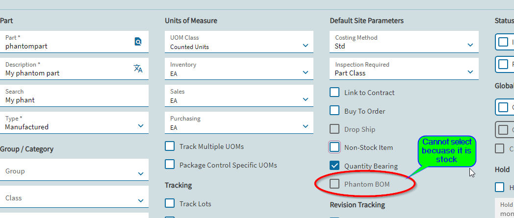

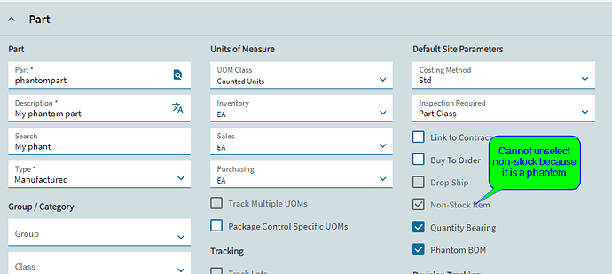

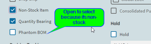

It’s not possible to have an item be Quantity Bearing and a Phantom BOM.
Funny, we have lots of Phantoms set as Quantity Bearing. Just not sure if they should be.
CORRECTION to above…
QUANTITY BEARING, Yes, it can be quantity bearing…
NON-STOCK: THIS is what it needs to be… Phantoms cannot be set if it is a stackable item. it must be Non-Stock.
