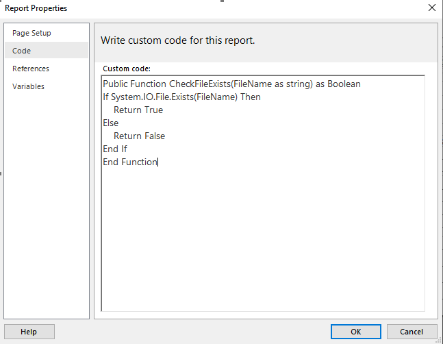

You can also add Custom Code to hide the signature if image doesnt exist (so you dont see the red x) – by right clicking on the Gray background on a Report and clicking Report Properties and then there is a Code section to add “Global/Shared” Code.
Public Function CheckFileExists(FileName as string) as Boolean
If System.IO.File.Exists(FileName) Then
Return True
Else
Return False
End If
End Function
And then you can use the expression below to set the visibility of the textbox which contain the image.
=IIF( Code.CheckFileExists(YourFilePath),false,true)
Just Remember the SSRS Service Account needs to be able to read the UNC Path where you store images.
