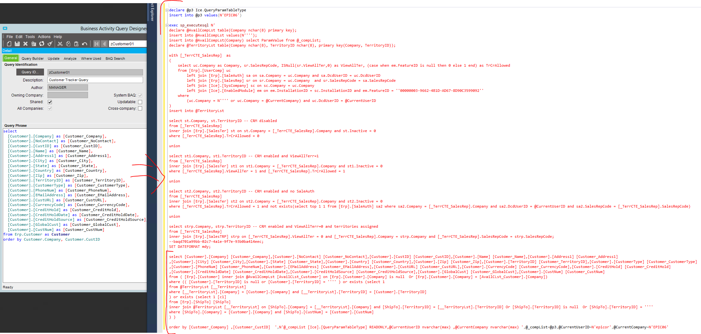

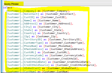

What’s odd is in the BAQ I have several inner joins and left outer joins. But in the Query Phrase, I see that Epicor placed cross joins to three tables.

Epicor 10 appends extra query checks to your BAQ query in the background.
If you want to get the final query, you can do so using SQL Server Profiler, and that’s assuming you have granted access to the tooling and db.

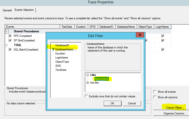

Open an SQL Profiler session and change the template to Tuning:
Add a filter to reduce unrelated activity

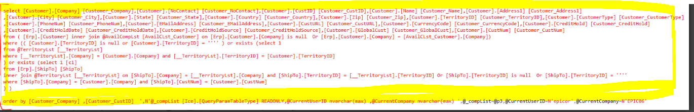

Go back to SQL Profiler trace and stop it. Then search for a meaningful keyword
Once found, copy and paste it on SSMS, and compare it to your BAQ Phrase.
Run both queries and compare the results to ensure they give the same data.
image VS image
VoilĂ , notice that your query is only a part of the executed query.
I have compared couple more and the same principle applies.
Also, it looks like every time you add Customer table, the same territory and salesrep checks will be added to the final query. This is probably similar to what @Bart_Elia said about Payroll magic.

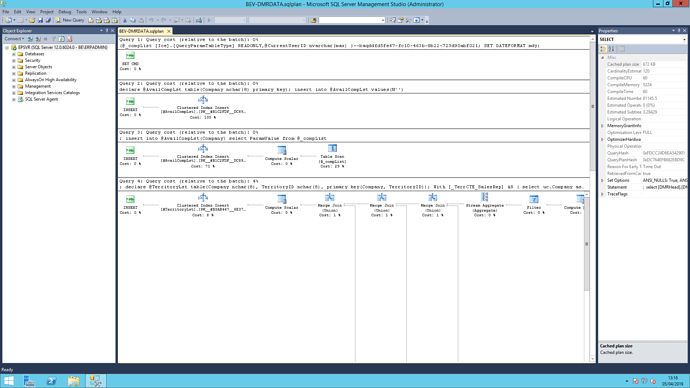

Once you have tested a BAQ you can run “Get Query Execution Plan” from the actions menu.
This can then be opened with SSMS.
I had a to debug a finance BAQ that running out of memory and failing and used this. Turned out the SQL being executed bore no resemblance to what shown in the BAQ designer “Query Phrase” window!
I copied the query phrase directly to SSMS and it ran in a few msec :smiley:

I did the former already a few days ago. However, the execution plan is a graphical representation of the executed SQL. Is there a way to extract the requested query vs. the executing query? An Oracle database can track the submitted query and the executing query.
