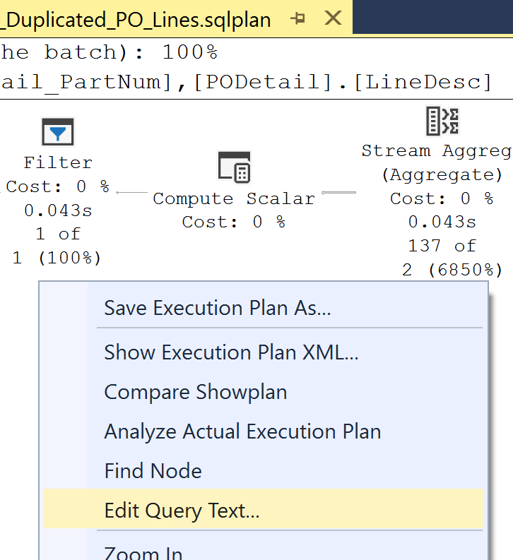

(Where you can right click on the plan to get the SQL…)
