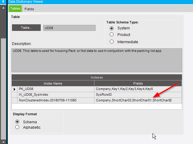

The joins should be done by an index. Removing or Adding the company is incorrect, the proper answer is to join on the indexes. (if you can)
If you look in the data dictionary it lists all indexes, joining on ANY of these indexes should igve you better performance, not joining on at least an index will require a full table scan.
As an example above joining on just “PartNum” is bad, however joining on any of these combinations should be better

Just an FYI, the data dictionary will also pick up added indexes. The last one is one that I added.

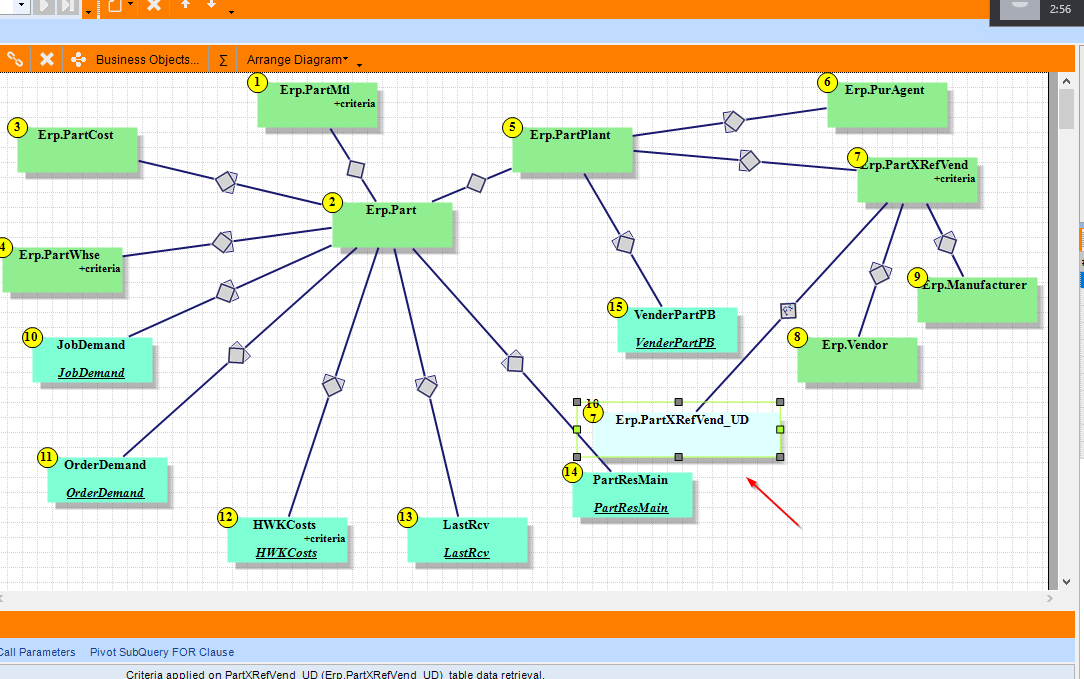

That funny blue UD widget may be the problem…
I actually ran into that today, only worse. I added a table, added UD Fields to the BAQ, saved, tested, and all was well…
BUT upon returning, i had the UD table showing (it should never be there)… and worse, it was not joined to anything. So… it took even longer.
In E10, there is an ERP view that makes it so that you should not have to refer directly to the Erp.PartXRefVend_UD directly. It should already come along for the ride with its parent.

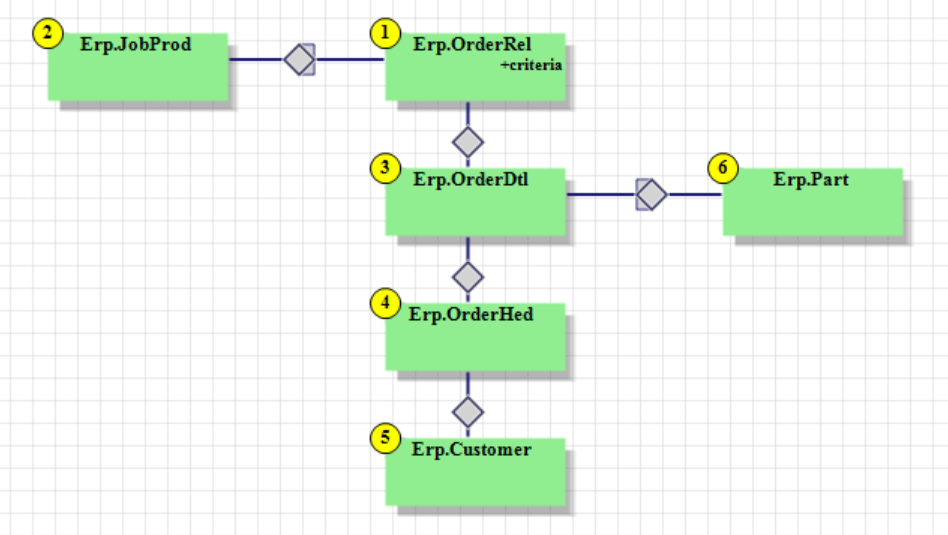

Thank goodness I saw this post!! I was joining on company with the customer table and it was fast, until some other part of the query changed. Then it was an issue for some reason.
I just ran afoul of the Customer voodoo. We had a BAQ that was running fine for over a year. Then last Wednesday it suddenly started timing out. It was timing out in the REST API as well as in the BAQ Designer. @ERPSysAdmin’s guess that it might have something to do with a cache prompted me to create a new BAQ from scratch, adding features one at a time and testing at every step.
I joined Customer to OrderHed and all was well. The query returned ~500 rows in ~50ms. Then I added a subquery criterion on a custom field on OrderHed. The BAQ became so slow that it couldn’t even return 10 rows before timing out. Removing Company from the Customer join fixed it. Now it runs in ~150ms. @timshuwy, I owe you a beer!
