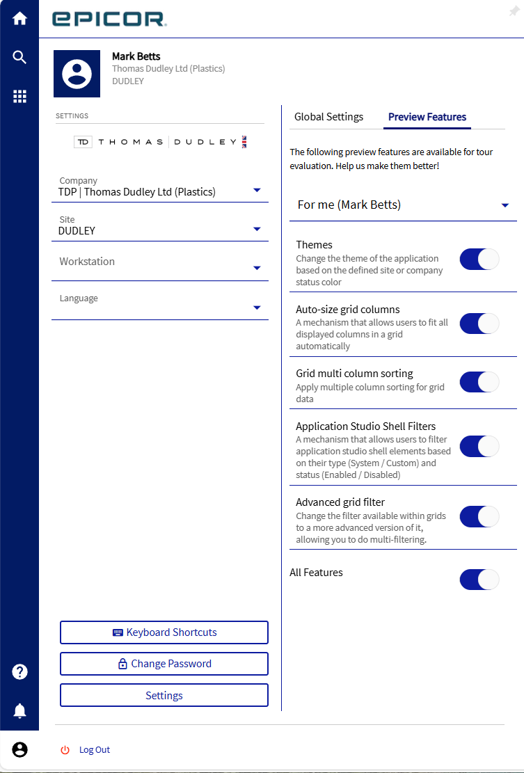

2025.2 Also has a new Grid you can turn on / odd in advanced features. Maybe something about that is causing the issue?

I turned them all that off when I started having issues on this update. It made no difference, which I expected as none of my users have preview features turned on.
