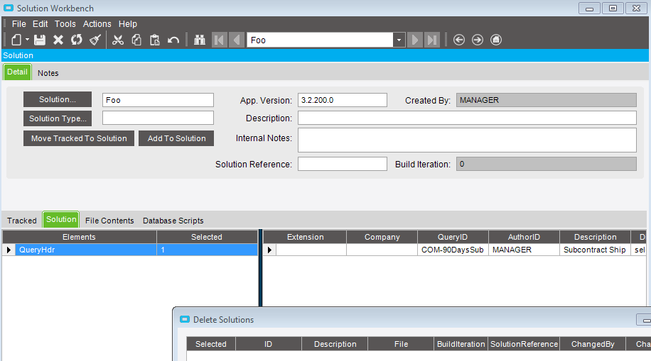

Using the Delete solution action you can see any installed solutions, including CSG installed solutions, but those solutions don’t show up in the solutions search, unless you created a BAQ search. That doesn’t make it easy to be able to actually browse the content of the installed solution, which from time to time can be useful.

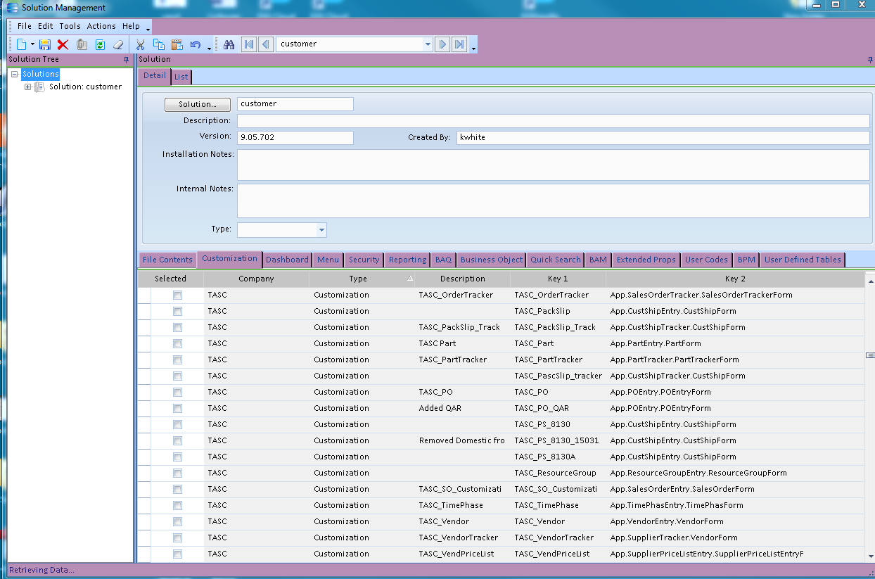

In E9 i like how it display…it can be cumbersome but in E10 I feel there are extra steps.
Here is E9…I create the solutions hit save and everything pulls in and listed below. When I select certain things like a Dashboard it will ask if I want the relataed BAQ. In E10 you have to got Add to solution then select the area you want pull in in…I am still trying to figure it out but I don’t like it at all.
Here is what it looks like in E9. Once i hit save everything pulls in and I can pick what I want and need all on same screen.

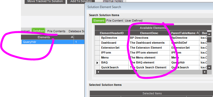

The ‘Element’ type on the left in E10 in the grid instead of the list of infinite tabs on the E9 right side. But the names do not align.
I assume if the names were fixed this would be less of an issue
e.g.
E10 shows the raw table names (great for DBAs, bad for normal humans)
E9 shows the human understandable description of what they represent
Something like a check box to show ‘Technical Table Name’ versus ‘High Level Description for normal humans’ would solve this?
