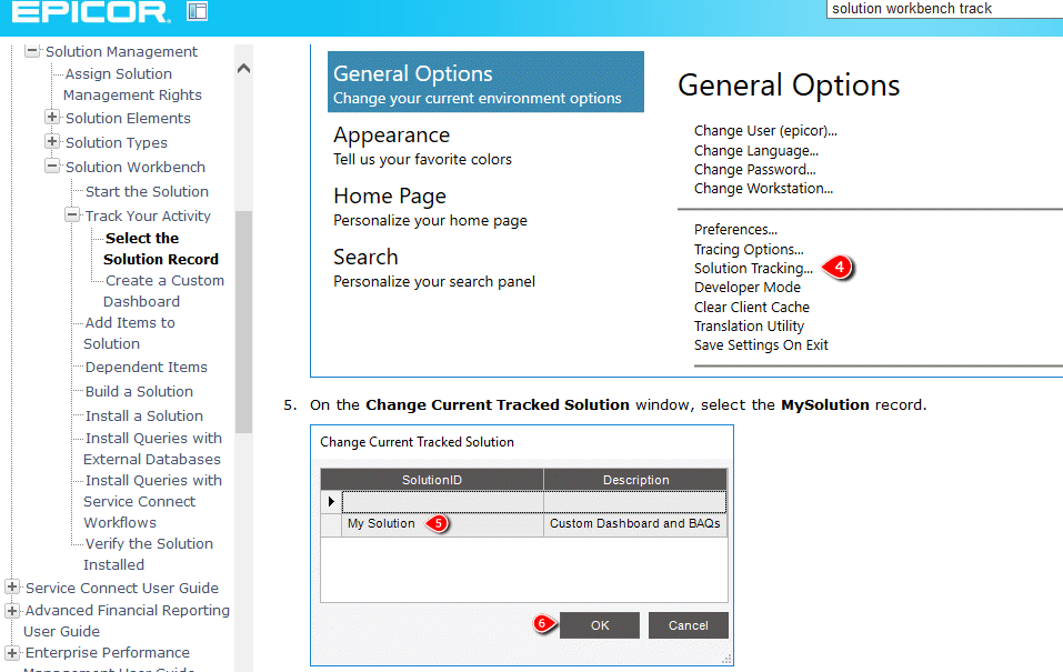

Search Solution Workbench Tracking for the tracking…
