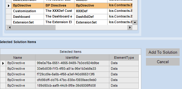

I am still learning about BPMs.
I have created my first BPMs in test and I am preparing to bring into live.
To add to the solution workbench - is BP Directive the correct solution item?
Are there others I need to also consider?
@FionaH BpDirective is the choice, but for me and my version using solutions for bpms causes issues of duplication on an update to the bpm. I tend to use directive export and directive import and use the group and check replace existing group. I used a solution this week and was embarrassed in a demo when the bpm fired a popup multiple times.
Thank you for your reply Greg. I hadn’t come across directive export yet, and I think I’d prefer this method instead of the Solution Workbench.
Installing solution also have ’ Remove Directives with Matching Name’ option. Once it is check it will not create duplicate bpm directives.
True, but only if the name has not changed or you have not merged or deleted any bpms. Using the group clears all directives from that group and starts over.
