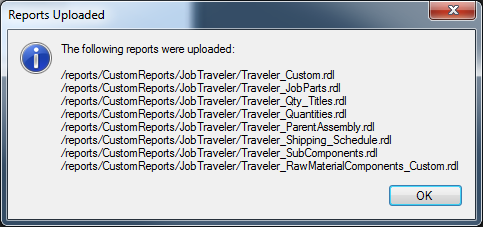

However, if you use Actions -> Download SSRS Report via Report Style Maintenance, it downloads them all.
Make use of the same functionality during, Solution Workbench .cab creation - or - an additional prompt asking if you want all or single.
Then of course Install Solution should replicate the functionality of Report Style Maintenance(s), Actions -> Upload SSRS Report
As of 10.2.400.x atleast I noticed the Sub-Reports are NOW included (when building the .cab) and uploaded via the Solution Workbench. I already deployed a few Reports only via the .cab
Can someone confirm besides me, then we can mark this Feature as closed. When was this implemented? I am on 10.2.400.10 and it works now!
