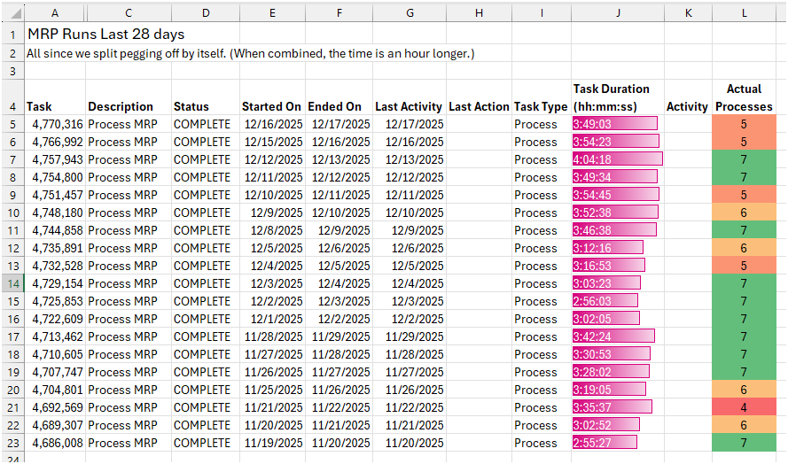

MRP is set (by us) to 7 processes. Yet several days lately, it’s done fewer than that.
7 processes seems fine for us. Honestly it seems to have fairly little bearing on things. There are many other variables, like the number of orders and their distribution.
The problem here is actually the erroring out that leads to this.

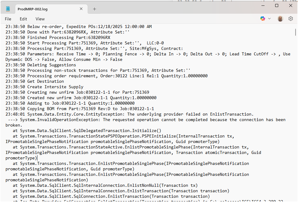

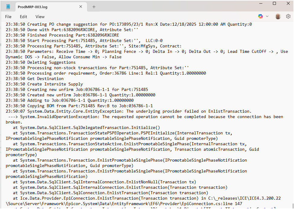

So when it runs 5 instead of 7 processes (yesterday), it does start with 7. But early on, 2 of them fail. This is the fairly useless error:
The underlying provider failed on EnlistTransaction.
---> System.InvalidOperationException: The requested operation cannot be completed because the connection has been broken.
Now this next part sure sounds like an amazing coincidence…
The two processes that failed were the ones that had assigned to them the two oldest (very old) orders in the schedule - dated 2020 and early 2021. Yes, of course, something is amiss here for these to still be open, but I’ll set that aside.

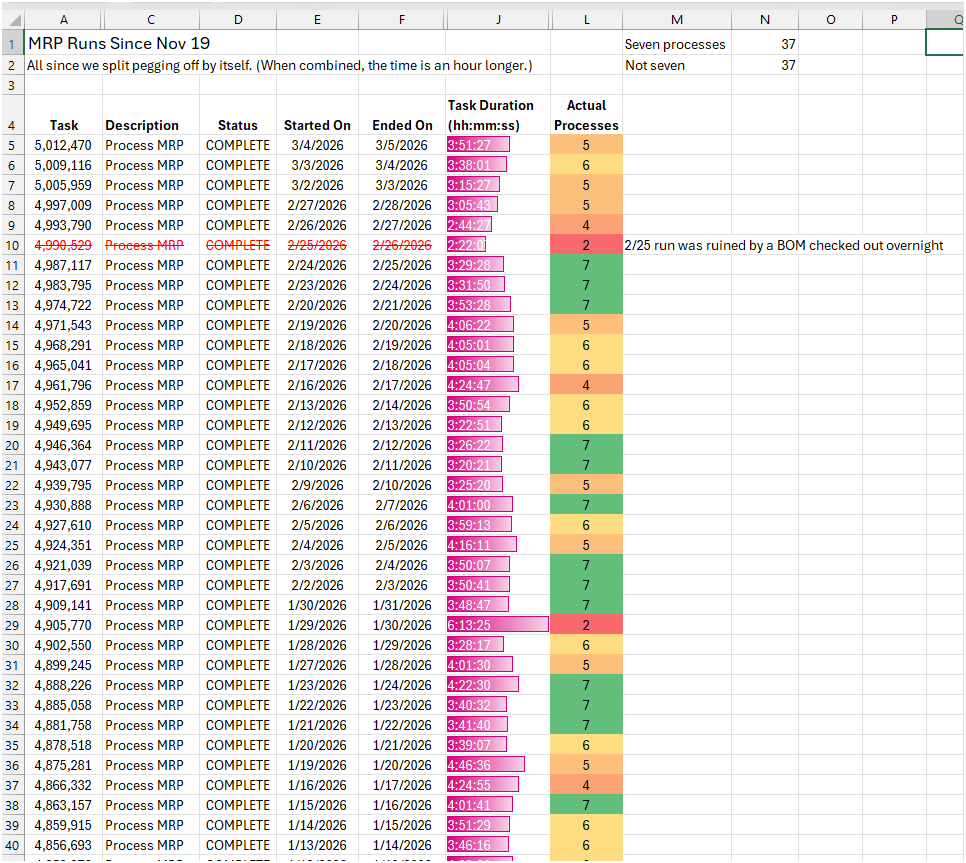

I came by just to say that it still happens 50% of the time - literally. 37/74 MRP runs since I started tracking it. It’s a livable problem, but frustrating. Support is not concerned. Good for them.
