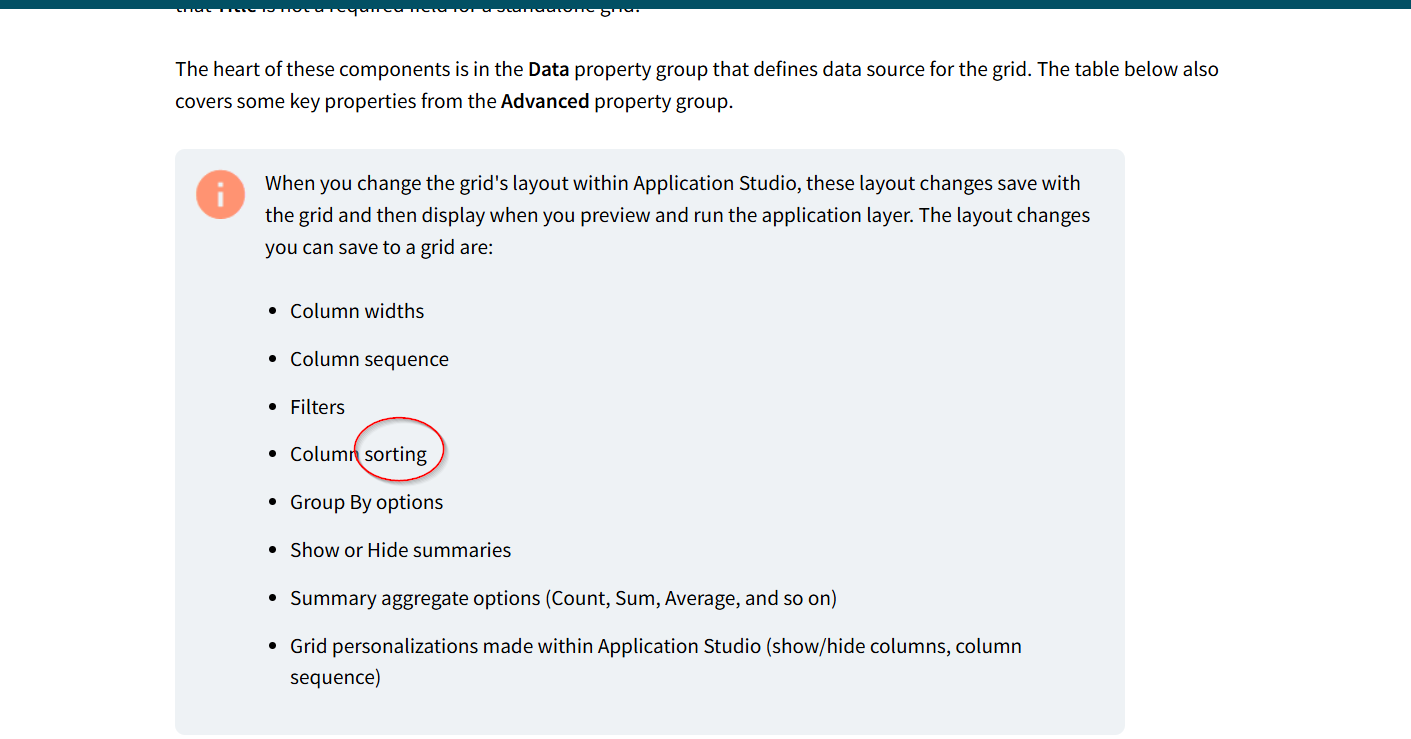

I also see this in the documentation but it doesn’t work, i.e., after sorting the grid in app studio, when running the application, the grid is not sorted.

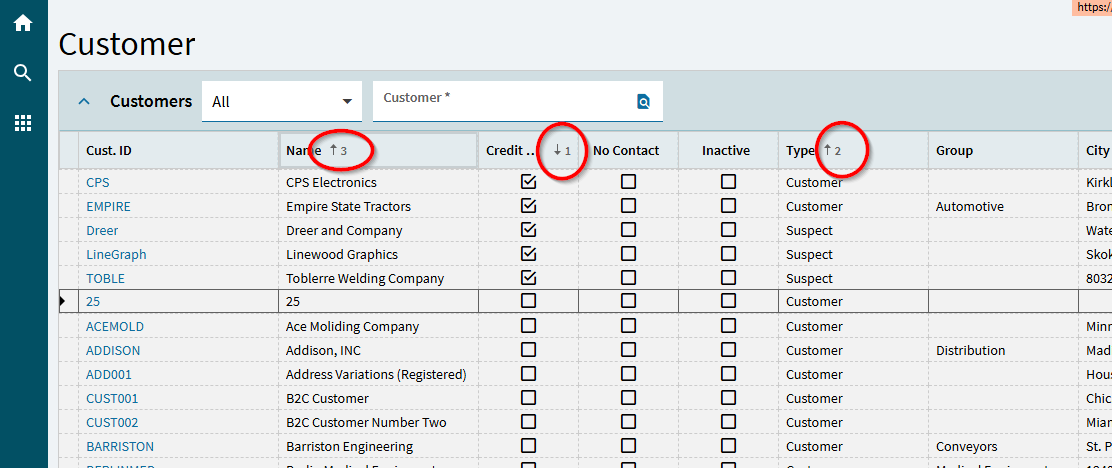

ok… i will drop this little nugget to you all (:safe_harbor: Safe Harbor statement goes here :safe_harbor: )… Our UI/UX team has been hard at work with some of the grid features, and in current code which should be coming in Kinetic 2025.2, there is this cool sort feature that really works well. I have been playing with it. You click on the column, and it sorts. if you click on another column, it adds a number showing you that it is the second sort. do that to a 3rd, 4th, 5th column and it keeps adding sorts. Double click, and it removes the sort. Single click and it changes the sort direction. I tried this up to 11 column sort (I ran out of fields to sort by so it may go beyond that, but, an 11 column sort is rather ridiculous).
Here is a screenshot of how it looks with a 3 column sort: I first sorted by credit lhold to bring all the credit hold customers to the top. then by customer type, and then an alpha sort of the name.

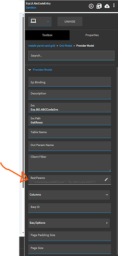

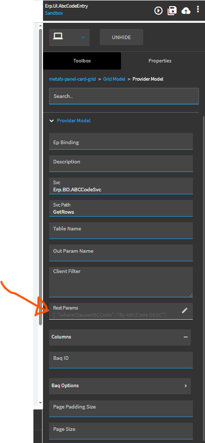

you propbably already know this, but FWIW, you can do server-side sorting in gridModel.providerModel.restParams for some BO Methods such as GetRows and GetList (I believe) like so:
	"whereClauseABCCode": "By ABCCode DESC"
call:
/Erp.BO.ABCCodeSvc/GetRows?whereClauseABCCode=By+ABCCode+DESC&pageSize=80&absolutePage=1
oddly it’s in a where clause so there’s some legacy parsing going on some where. :roll_eyes: :man_shrugging:

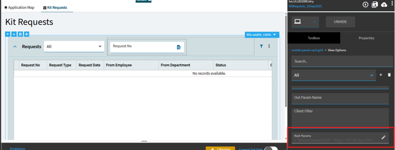

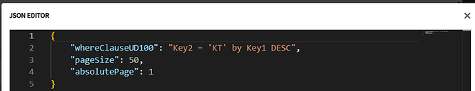

Not sure if this will help you but I was able to get the Grid Sort to work from metafx-panel-card-grid > Advanced > View Options > Rest Parms

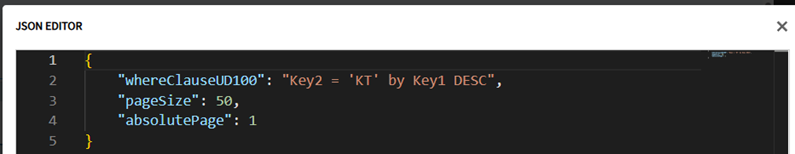

I already had the whereClause in this location as I was only loading a specific record type in this grid. So I added the “by Key1 DESC” and it worked. I tried the location where jbooker suggested first but could not get that to work.
“whereClauseUD100”: “Key2 = ‘KT’ by Key1 DESC”,
“pageSize”: 50,
“absolutePage”: 1
Definitely frustrating as previously I sorted the Grid descending in the custom layer and then saved the layout and it worked fine. Recently had to make changes to my grids and found that option no longer worked :scream: So thankful for this user group!
FWIW, As far as I know grid.ProviderModel is ignored if you have one or more View Options. Views are provider models - the way to have many provider models for your grid. Since your grid has a View defined, you make the change there instead of grid.ProviderModel
