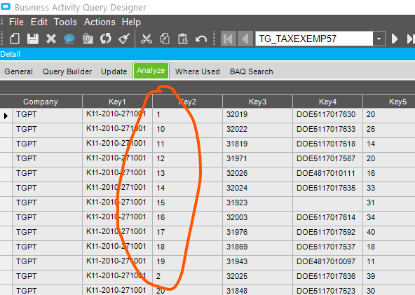

I have a list of number integer but I’m having some sorting in my BAQ and it appear as following:
Does any know how to make is as sorted display as 1,2,3,4,5,instead of 1,10,11,12,13…

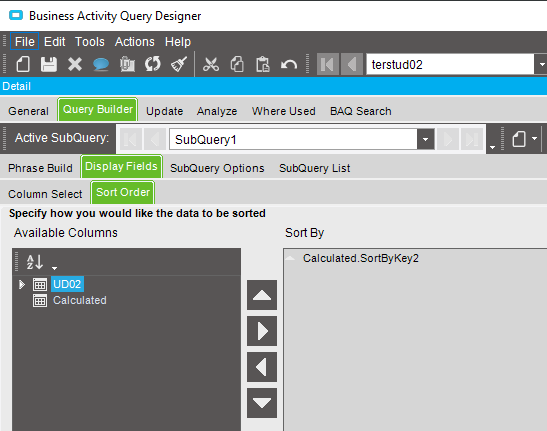

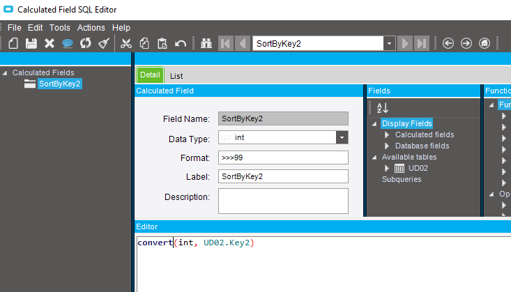

I’m no expert, and I only learnt it this week,… first step is to create a calculated field, field type int, format >>>99 in the expression box type in convert(int, UD02.Key2), and then sort by that field
it only works if what is in key02 is a number

Ah yes, this is what I want, thanks Barker…
