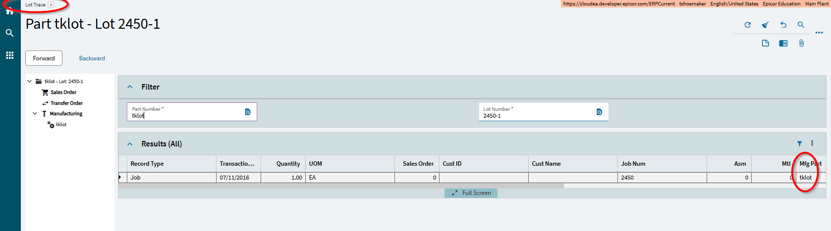

You should be able to use Lot tracker. If your FG has a lot number, then you should be able to look at Lot Tracker to see all the material by lot that went into building that Finished Good.

OH… and if you do this, then the PartTran table shows the legacy of the lots. you can see every place that lot was used/shipped over time. You can build queries. But there is also the “Lot Trace” program that shows both where Forward and Backward tracing.. this screen is part of core kinetic.
