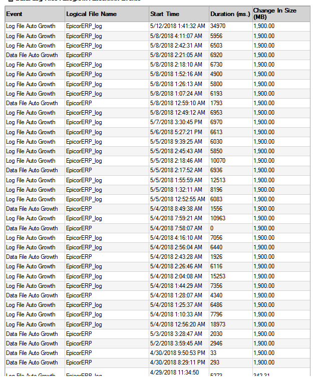

The performance and diagnostic tool (PDT) Config Check reviews the free space (aka: air aka: empty pre allocated space) of the MDF and size of the LDF. The specific KBs that discuss how to pre autogrow your MDF and shrink your LDF are below.
NOTE: So, to prevent growth of the LDF you’d follow the steps for the MDF pre-growth, but, instead select your log file instead in SSMS.
SQL003
SQL Server Available Space - MDF File space available
