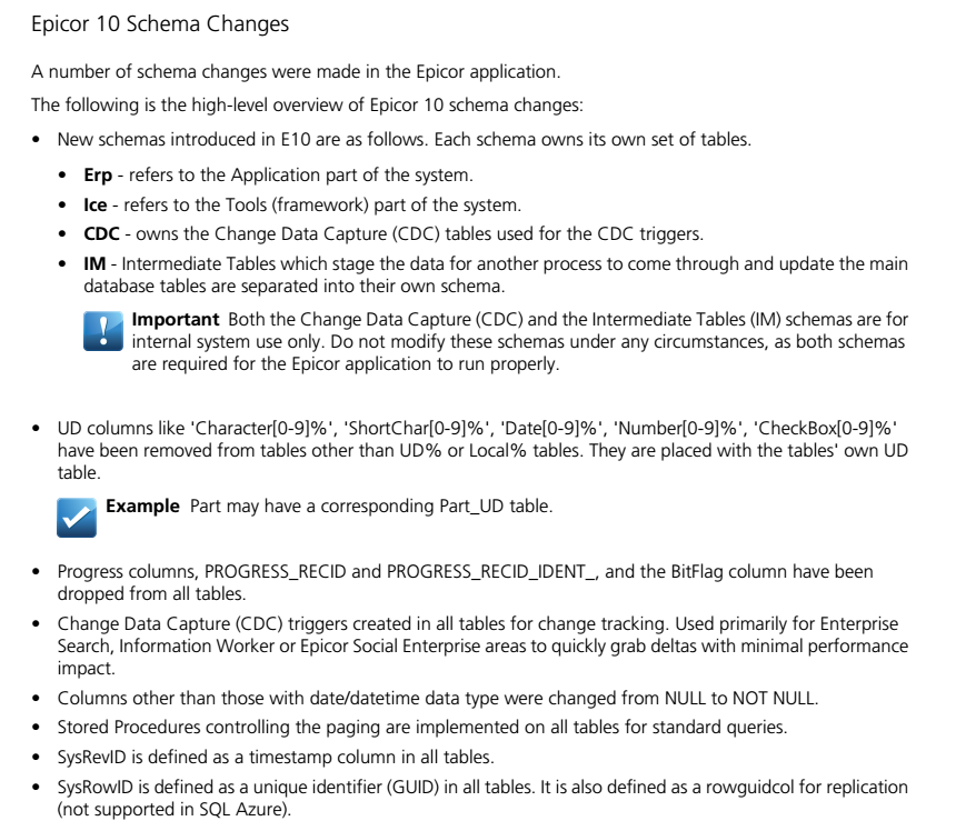

I found this in the Epicor ERP Feature Summary for 10.2.100 on EpicWeb but it’s a very high-level overview for Epicor10:

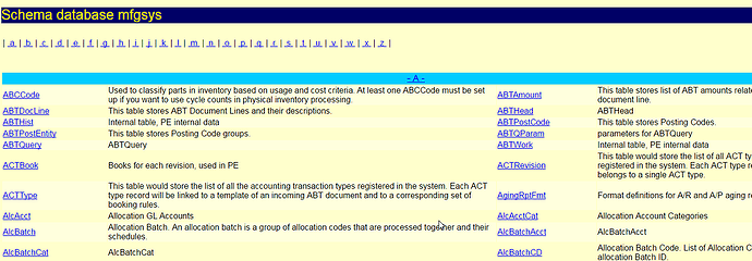

This is an older post requesting an Epicor10 DB Schema which gives you some tools that you can use to create a schema and a link to the Epicor10 ERD.
