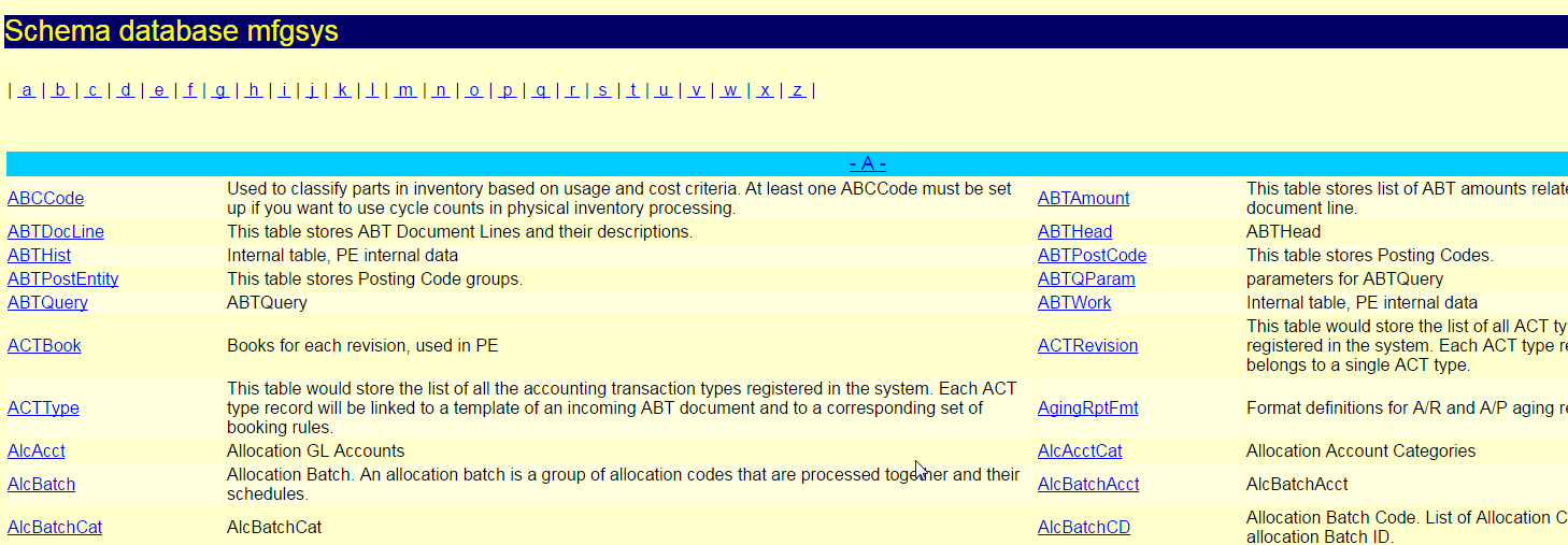

Does anyone have a Epicor 10 SQL database schema? We have one for version 9 and are looking for one for version 10. Any help is appreciated. Below is a screen shot from our version 9 schema we currently have as a reference to show what we are after but for version 10.

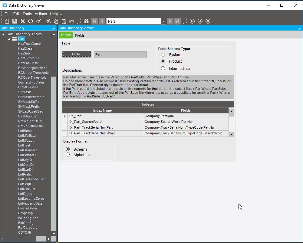

They have what they call the data dictionary. It’s under system setup, system maintenance. You pick the table you want to see, and it lists the fields and the descriptions. You can print to PDF using a filter too to make a report. I haven’t been able to get all of them to populate on one report though (it’s probably too big). I don’t use it much because I think it’s easier to use the help/field help/technical to describe the field and tell you what table it’s in, and then I look at the tables in a BAQ, since that’s where I usually need them anyways. Does that help?

We are aware of the one inside of epicor, we were looking for one that is similar to the E9 one that was on the old yahoo group that loads in a web browser.
Thanks Jose, that one you linked me to doesn’t seem to have the same features as the one we have for 9 and maybe it just isn’t available. That one would let you click on the tables themselves and even do cross linking on the fields. I know we got the 9 one from the ‘downloads’ folder on the old yahoo group.
