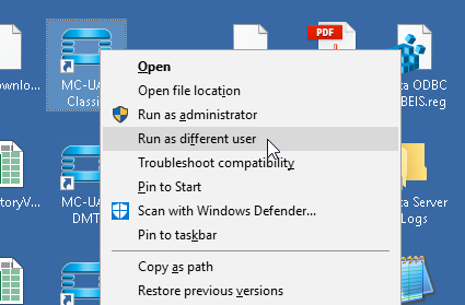

And FWIW - We user Windows Authentication (which is kind of like SSO), and to run the client as another user, Hold the SHIFT key down and right click the client icon. Then select “Run as Different User”
You’ll then have to provide the users Active Directory (i.e. Network login) name and password

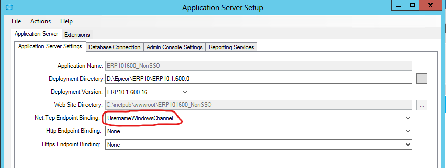

Thanks to help from Epicor, we setup a Non-SSO AppServer (because SSO is dependant on the AppServer setup) so for this AppServer you will want to select “UsernameWindowsChannel” as the Net.Tcp Endpoint Binding:
Then we have a separate Non-SSO Epicor icon that we use to log into Epicor that prompts us for a username and password every time:
