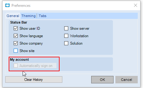

However you don’t have to create a sysconfig file for each workstations, if you have different users that want to login automatically each user can setup this for themselves. They need to login to Epicor
Click On Options → Preferences and check the Automatically Sign on Flag
Once they’ve done this, the system will encrypt their password in their sysconfig file.
