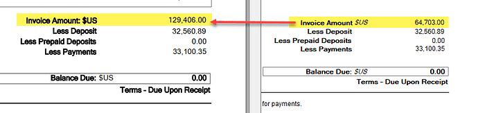

I’m trying to use the VB.Net code for a total field.
In the report builder, it looks fine (should be 64k), but when I preview from Epicor, it doubles that number.
Why is that happening?

** Edit - Actually, every time I run it, it seems to add 64k to the total. I have the initialize function in the InvoiceNum group, so it should be resetting to zero every time a new invoice pops up.
Resetting the variable after the total was displayed seemed to clear this up.

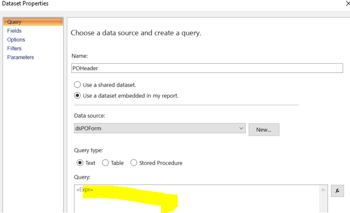

Aaron,
I found a problem that every time I downloaded the report the query code in the dataset for some reason was duplicating itself. It happens in a lot of reports, so just as a sanity check I would recommend to check it. This right here
