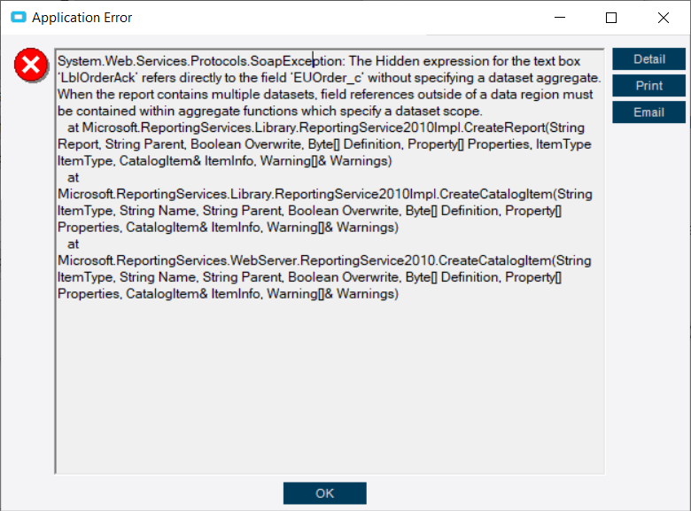

I’ve currently got: =IIF(Isnothing(Fields!EUOrder_c.Value),True,False) I’m using the display options of the table
It’s currently giving me
Thanks again.
Aaron
Based on the error, the field you are referencing is not in the same dataset. Are you passing the EUOrder_c in the RDD?

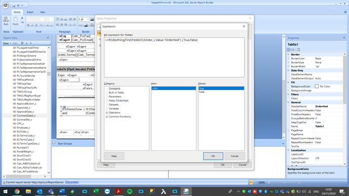

You could try:
=IIf(IsNothing(Fields!EUOrder_c.Value,"Name of the dataset it is in here"),True,False)
Or use First().
=IIf(IsNothing(First(Fields!EUOrder_c.Value,“Name of the dataset it is in here”) ),True,False)

I’m still getting the same error as previously.
Well, if the field EUOrder_c has been added to OrderHed dataset, then what is the dataset specified for the Table that you are trying to “hide”?

Everything is good in terms of the table and fields but this expression is causing some issues? All I want it to do is show the table if EUOrder_c = True and Hide the table if EUOrder_c = False.
Kind regards,
Aaron
Solved it with this little bad boy.
=IIF(First(Fields!EUOrder_c.Value, "OrderHed")=False,True,False)
Woohoo :slight_smile:
Yep, you told us that didn’t you, it was a boolean, nicely done, you nailed it!
