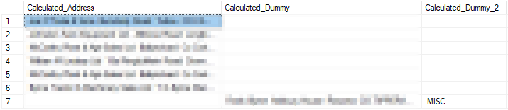

I’m not sure why but my IIF Statement doesn’t seem to want to work.
=IIF(IsNothing(Fields!Calculated_Address.Value),Fields!Calculated_Dummy.Value, Fields!Calculated_Address.Value)
There is data available.

Hi Aaron,
Looking at your image there is data in Calculated_Address but nothing in dummy.
I might have misunderstood but your if statement is checking if calc_address is nothing (which it isn’t), then show Dummy otherwise show calc address? Does this just need switching around?

I swapped them around resulting in.
=IIF(IsNothing(Fields!Calculated_Dummy.Value),Fields!Calculated_Address.Value, Fields!Calculated_Dummy.Value)
But didn’t resolve anything.
=IIF(IsNothing(Fields!Calculated_Address.Value) OR Trim(Fields!Calculated_Address.Value)="",Fields!Calculated_Dummy.Value, Fields!Calculated_Address.Value)
Resolved the issue.
