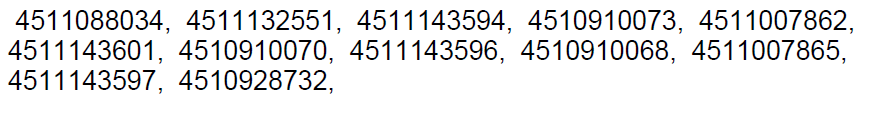

So we built a new BAQ report using the knowledge base on E10 to concatenate detail rows in a BAQ to a single delimited field… This ended working out very well and we have the data normalized the way we want it before passing it to SSRS.
But we have one small nuance that we would like we would like to see if we can work out.
Is it possible to control when the line wraps in the textbox that the string is tied to is SSRS?
The individual pieces of data (between the commas) can be all different sizes and the string itself overall will vary. But we do not want the data to wrap and break up a single string between commas. We would only want the line to wrap after a comma. Hope this makes sense
This is just an idea, untested.
Many text controls will naturally wrap at whitespace. If there is no whitespace available, it wraps where it has to. If it is possible to replace the commas with comma-space, it may wrap where you want it to.
Ahhh, so simple… rookie oversight.
Thanks,
Andrew
