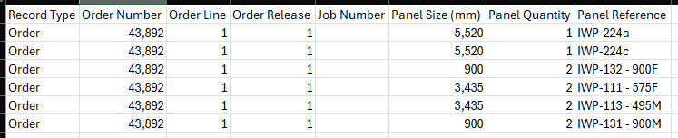

the table above shows a list of the fields i am pulling from a BAQ from our UD01 table, i have added parameters to this so you need to enter the OrderNum / OrderLine / OrderRelNum to filter down the data accordingly.
i want to create a label for each panel size and quantity which displays the O/L/R, size, qty x of x and the panel reference.
so to add some clarity, in the dataset above IWP-224a is 1 panel at 5520 so i want 1 label
IWP-132-900F has 2 panels at 900 so i want to print 2 labels for this one.

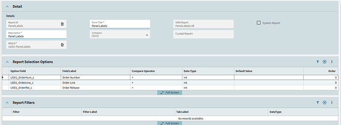

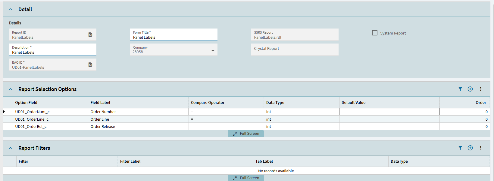

I have created the BAQ,
I have created the BAQ Report
I have added the filters to allow to filter down the data
from this point i literally have no clue where to go for the SSRS…really hope someone can point me in a direction to get me started.
