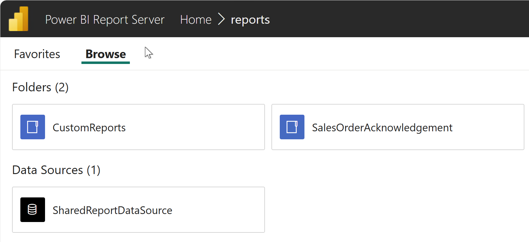

Has anyone ever actually tried PBIRS, Power BI Report Server, with Epicor Kinetic?

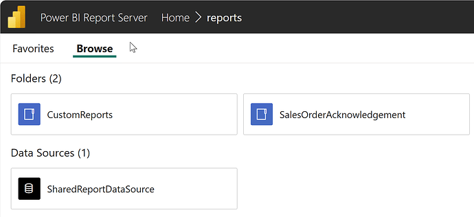

Just uninstalled SSRS from a working machine and installed PBIRS, the installer and configuration are near identical.
Reconfigured Epicor App in the admin console, where the only thing i had to change was the Report Server location to C:\Program Files\Microsoft Power BI Report Server\PBIRS\ReportServer
From there everything i tested worked as it currently does with SSRS. print previewing Standard report, copy report style, download, modify in report builder, upload, print preview custom report style…
Not saying there isnt issues but non i hit from an initial install and test.

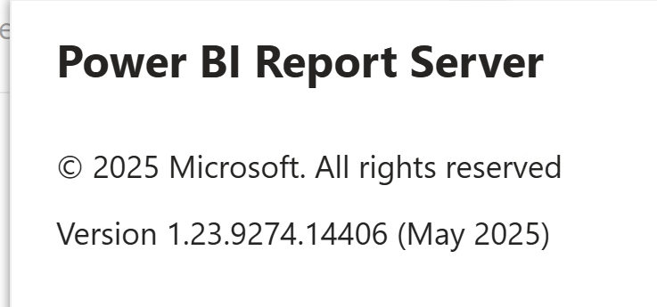

Note, this is with an SQL 2022 back end for Kinetic 2025.1.6 and the Report Server Db. However it is with the latest version of PBIRS.
