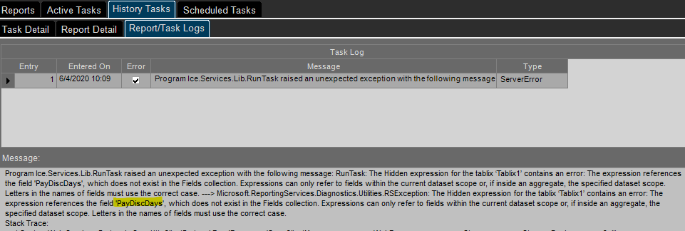

I’m experiencing something strange in SSRS and really have been since day 1 on E10. I will use AR Form as an example. I’ve copied the style/report. Done nothing at all to it and it previews just fine except long part descriptions are cut off. If I increase the text box height by even a single point or check “Allow height increase”, the form breaks. This is not limited to just this form. The error is ALWAYS "The expression references the field ‘PayDiscDays’, which does not exist in the Fields collection. But it does exist. If I undo my changes, the form is just fine with no error.

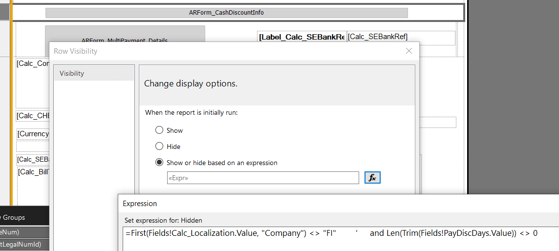

Mr. Chris: as a workaround you can Hide the Visibility formula for the ARForm_CashDiscountInfo subreport and the Invoice will then print.

Mr. Chris: Are you looking at the Visibility for the Tablix “Row” or are you looking at the visibility for the rectangle?
The standard Epicor form has a variable for that row.
DaveO
Both are set to Show. However, unfortunately, I set them both to Hide, set the part description text box to increase height and the error is back…

Yes the same exact error

Basically change the Hidden Expression from this:
Len(Trim(Fields!PayDiscDays.Value))
To this:
Len(Trim(First(Fields!PayDiscDays.Value,“InvoiceNum”)))

Where is this expression located on the AR Form?

The row is the ARForm_CashDiscountInfo subreport as shown by @DaveOlender
See below screenshot as well

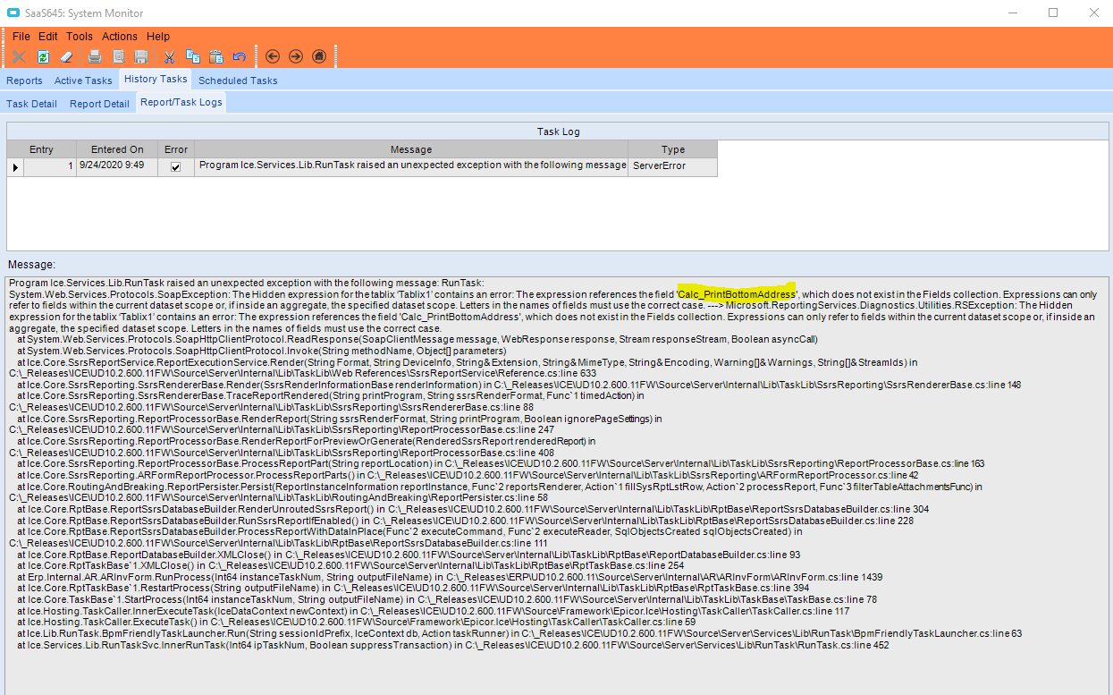

I have a similar error while printing invoices. I am not 100% sure which area on the form is causing the error.
Thoughts?

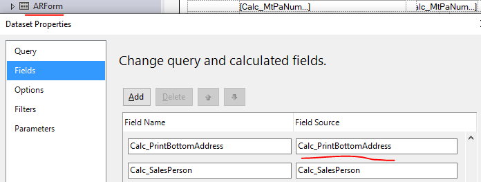

You must be using some really old or weird rdl because field Calc_PrintBottomAddress is not new.
It should be defined in the Data Definition as a calculated field of InvcHead and part of the query for dataset ARForm.
