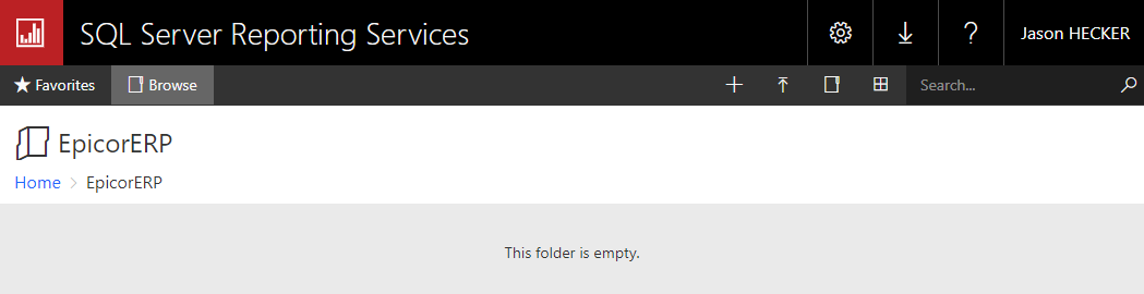

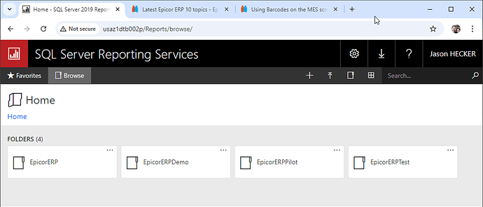

When I log into the SSRS I can see our various Epicor environments listed:
When I drill down into EpicorERP, EpicorERPDemo, or EpicorERPPilot, I see a message stating “This folder is empty.”

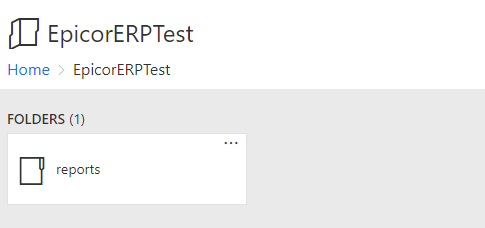

When I open up EpicorERPTest, I see the Reports folder:

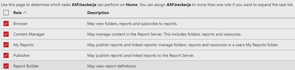

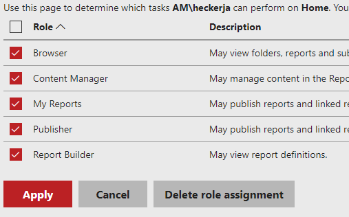

All permissions are set on the root level, and I am set up with all roles:

This is how it is set up for me, and for others that are able to view the report folder structure:
Those permissions are propagated from the root, through the entire folder tree.

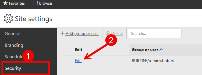

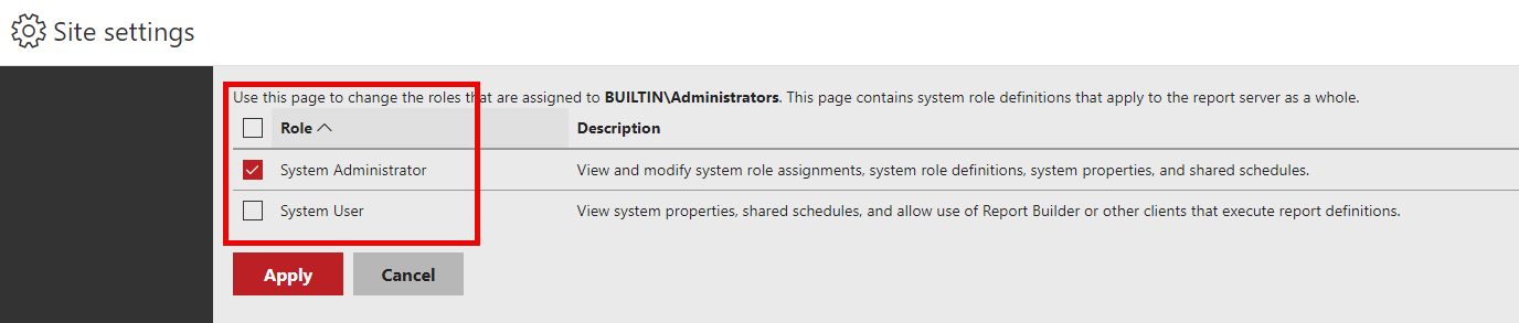

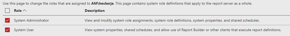

I forgot how it was worded… but I revisited this because it got me once before. This is what I was referring to in Site Settings > Security.

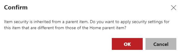

@jhecker Hierarchically, those security settings apply at the folder level too. If for some reason they are unchecked on that specific folder, you might not see anything. Try clicking Manage and Security on the EpicorERP folder.
Both boxes are checked there as well. (also tried it with just one or the other, no difference)
Like I said, all permissions are set at the root level and are inherited to all child items:
