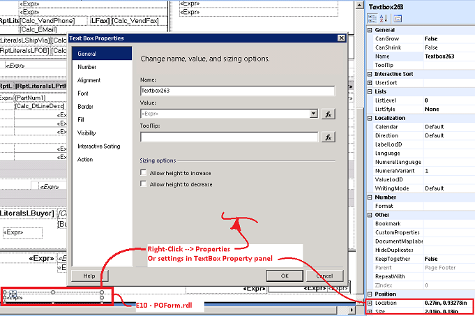

1.) E10 --> Report Style Maintenance - select custom style --> actions - download SSRS report --> to some working directory
2.) Launch Report Builder, open the downloaded file from step 1… edit as needed & save.
3.) E10 --> Report Style Maintenance - select custom style --> actions -Upload SSRS report --> from your working directory
I would normally expect to see something like this in Report Builder…
