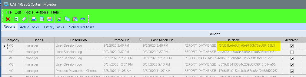

There’s not a way to use the GUID with SaaS, to my understanding. I think I can download data for a crystal report, but not for SSRS.
Justin is correct. Report Builder does not have direct access to the SSRS SQL Server.
Using the GUID isn’t downloading anything. It’s just a value to tell the rendering program where the data resides. The RDL should contain the connection info that is used for retrieving the data when it is rendered, and the GUID is used to specify which temporary set of data to use.
